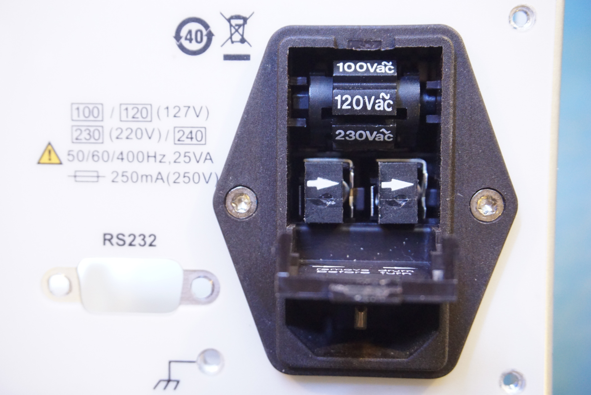

There are multiple windings on the primary side of the transformer and can accommodate mains voltages from 110V to 240V. The voltage selector is embedded in the IEC power entry assembly which can be seen in the picture to the left below:
Notice that the frequency of the mains voltage can be up to 400 Hz as this is designed to be able to work with aviation applications. To the right, you can see the fan used in the UT8806E. In UT8805E UNI-T used the same fan and it is fairly quiet.

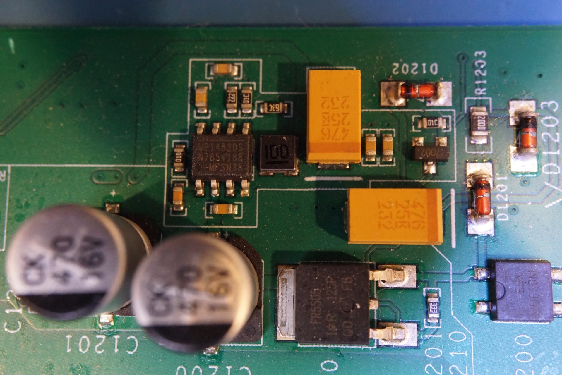

Unlike the voltage regulators used in the 8805E, none of the linear regulators used in this unit is on headsinks. And if you look closely, you can see some inductors. So I suspect UNI-T is using a mixer of switching regulators and linear regulators to lower the overall power dissipation. This is rather unusual to see inside a 6 1/2 digit multimeter.
And here you can see another buck converter, MP1482DS, used for powering the front panel.
