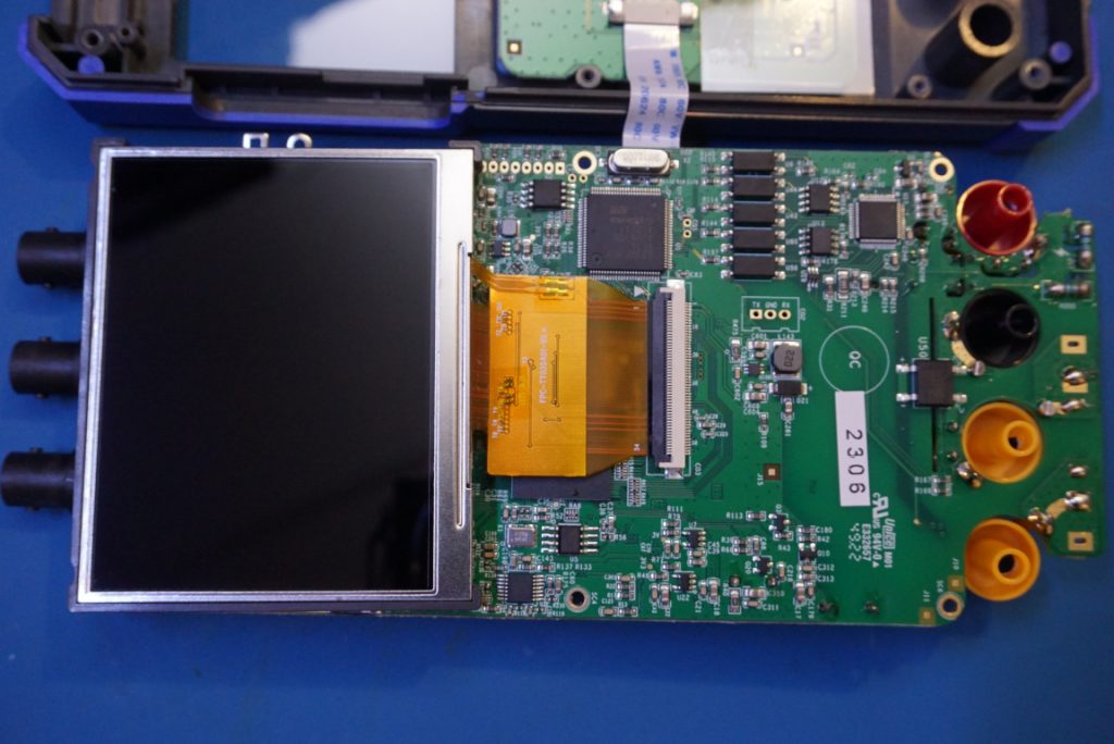

The main PCB of the HDS2202S (left below) looks virtually identical to that in the HDS2102S (right below). The only noticeable change is that the width of the input section shielding can had been extended by a few millimeter in the 2202. It now almost touches the negative terminals of the battery holder. There is also a cutout in the shielding for an electrolytic capacitor in the 2202.

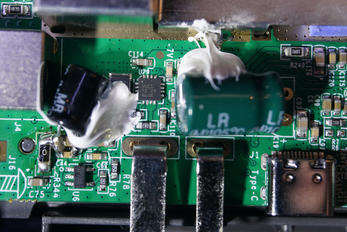

In the picture to the left below, The QFN chip seen with the marking of “VUCI” is a TLV62150 step-down converter chip from Texas Instruments. The battery charger chip used in the 2202 is slightly different compared to what’s used in the 2102, it is a SGM41521 Lithium Ion battery charger chip from SGMicro.
From a glance, the components layout on the other side of the PCB looks very similar to that of the 2102 and 272. In fact the keypad PCB is identical in all of these three handheld scopes.
Again, just like the 272 and 2102, the 2202 also uses GigaDevice’s GD32F303 microcontroller. Since the multimeter section is essentially identical in OWON’s HDS200 series lineup, it is not surprising to see that the DMM section (to the right below) is pretty much identical to what we have seen in the other two models.
Here are a couple of pictures showing the main circuit board.
