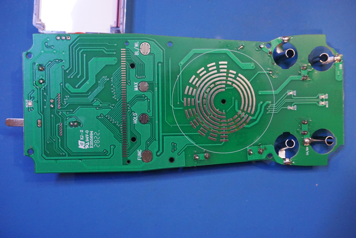

The reverse side of the PCB looks almost identical between the 118E (left) and the 118A (right).
Here are a couple more pictures showing the reverse side of PCB of the HT118E:
