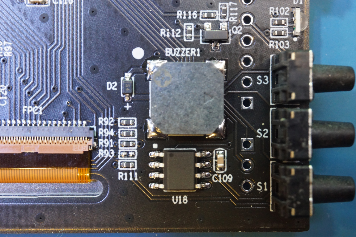

The picture to the left below is a close-up of the battery management section of the circuit. Here you can see an IP5306 charging and discharging controller chip that handles both the battery charging and power bank functionality. The picture to the right is a close-up of the bottom right corner of the circuit board. Here you can see a buzzer and an unidentified 8 pin chip, which unfortunately had its markings sanded off.

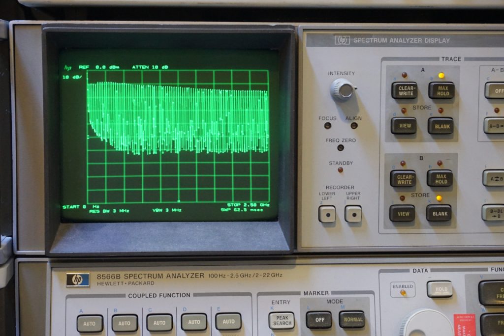

The NanoVNA-F V2 can be used as an RF signal source. Although the output waveform is square wave which has very high harmonics content.
The RF output power is also not entirely flat across the entire frequency range, the picture below shows the max-hold sweep between 50 kHz and 2.5 GHz and you can see a roughly 5 dB drop in amplitude towards the higher end of the frequency range. This also illustrates why it is important to calibrate the desired frequency range prior to making any measurements.
In the remaining three pictures, you can see the output set at 500 MHz, 1 GHz and 2 GHz with the output power set at 0 dBm. At 2 GHz output frequency, the amplitude dropped by about 5 dB, which is consistent with what we saw in the sweep output above.
