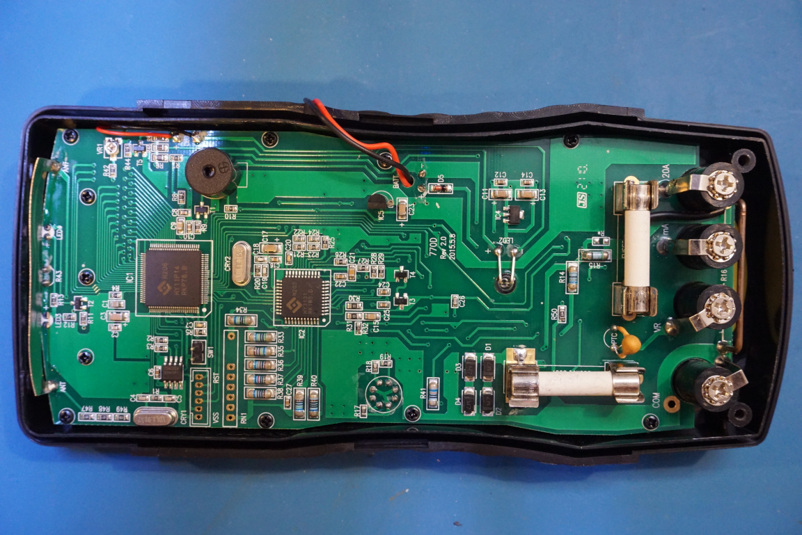

One drawback of this meter is the resolution in its lowest capacitance measurement range (99.99nF). In this range, it unfortunately only has a resolution of 10 pF, instead of the 1 pF commonly found on other meters in similar class. The temperature measurement range has a 0.1 degree resolution, which is better than most meters I have seen. Also to note is that although not specified, the display update rate is adequate in most ranges.
The meter operates on a 9V battery. The current consumption is at around 5mA depending on the range (with the back light off), which is quite decent. The meter utilizes a Holtek HT7530-1 3V low dropout linear regulator for the regulated voltage. This means that the meter can technically function with the supply voltage all the way down to just above 3V. Although the low battery indicator would come on when the supply voltage drops below 8.5V.
Another disappointment is the lack of adequate input protection. Besides a lone PTC, there is no MOVs to be seen. Since there is no MOVs to absorb any transient it is highly doubtful that this meter meets the CAT III rating that is stamped on the case.
Here is a close up of the circuit board. A Hycon technology’s HY11P14 mixed signal microcontroller is used to drive the LCD. The chip also has a built in 18-bit ADC. The main DMM chip used is an HY3131. It’s a 50,000 count DMM chip and has a 24-bit ADC built in. There is a 2K 2402A EEPROM on the circuit board, it is presumably used to store calibration and/or configuration data. A jumper labeled SW1 can also be seen below, I think it might be used to enable calibration.
