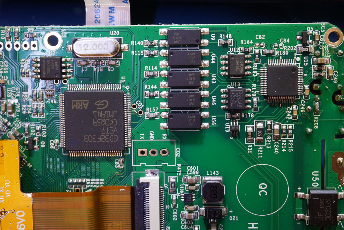

Next to the USB-C port, you see a BQ25616J single cell battery charger chip also from TI. You can also see the programming JTAG header. In the picture to the right below, there are four UMW 1018 long creepage photocouplers that are used to isolate the DMM section from the rest of the circuitry. On the other side of the board, you will see five of additional photocouplers.

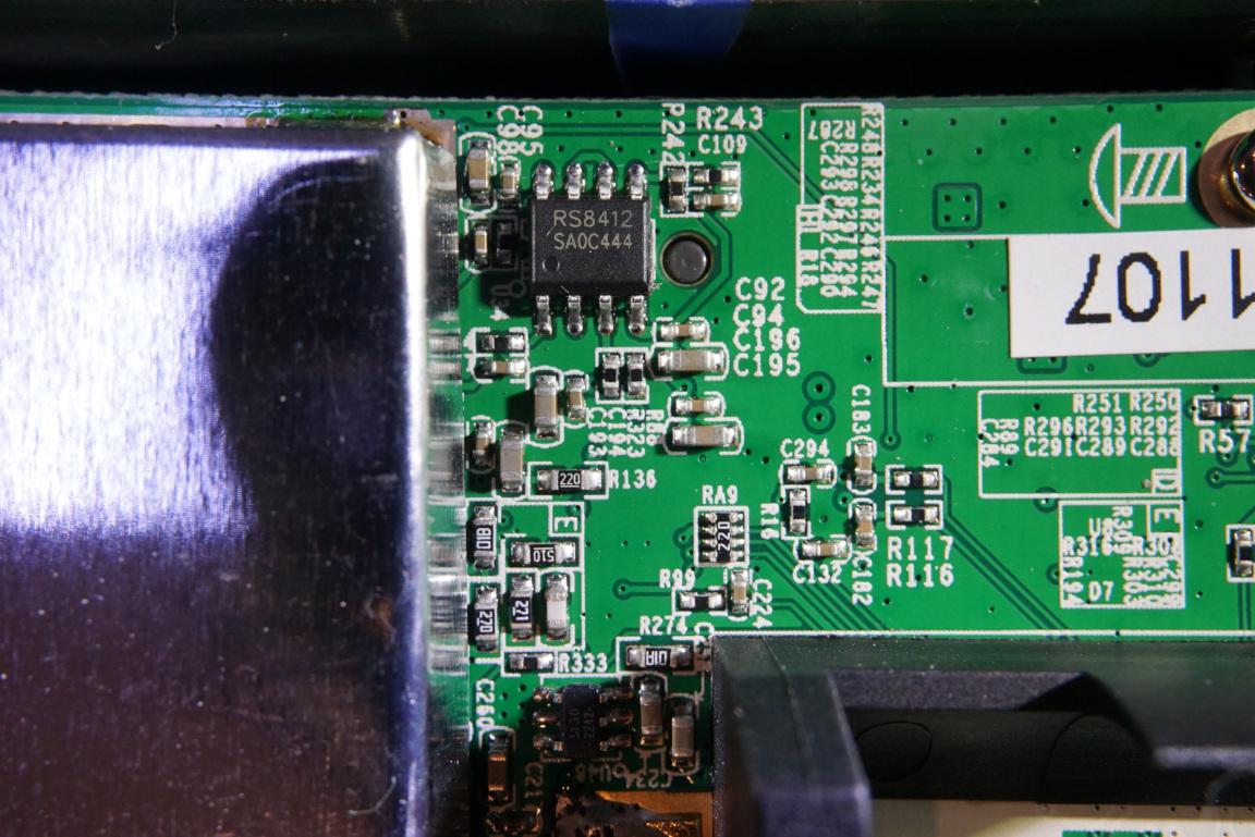

The 8 pin SOIC next to the shielding can for the oscilloscope input section is an RS8412 1.2MHz rail-to-rail output OpAmp.

The MCU used in this a GigaDevice’s GD32F303 ARM Cortex-M4 microcontroller.
