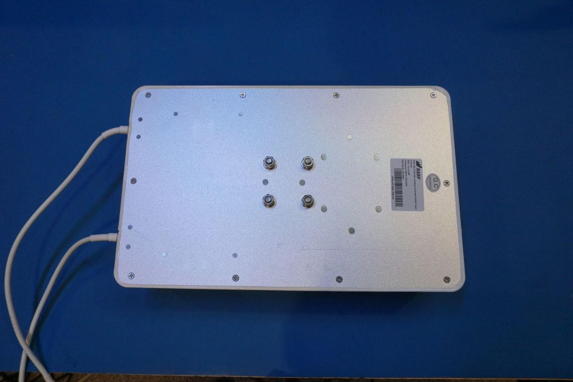

In this blog post, let’s take a look at a cross-polarized dual band MIMO Panel antenna that is designed for cellular signal booster. It can also be used with hotspots and routers within the designated frequency bands.
This dual band antenna is designed and made by RSRF. According to the datasheet, it operates between the frequency ranges of 600 to 960MHz and 1690 to 2700MHz with a modest gain of 6dBi and 9dBi respectively. These frequency bands pretty much covers all the cellular frequencies used for 3G and 4G LTE in North America. You can also use this antenna for low-band and mid-band 5G applications. As the low-band 5G lies between 600-850MHz and the mid-band 5G is between 2.5-3.7 GHz. Although this antenna only covers a small portion of the mid-band 5G frequency range.

\[C=Blog_2\left(1+\frac{S}{N}\right)\]Upon removing the antenna dome, it became apparent that this dual-band panel antenna is consisted of two sets cross-polarized dipole antennas. The smaller antenna is used for the 1690 to 2700MHz frequency band and the larger set to the right is used for the 600 to 960MHz frequency band.
The dipole designs for both the high frequency band and the low frequency band are similar although are built using different techniques. The larger antennas are made with gold-plated copper and are supported by some low RF loss material (could be either ABS or PTFE). In the picture to the right below, you can see some rod structures hanging off the corners of each arm of the dipole. I believe these are inductive elements and are used to fine-tune the frequency response of the antenna. The wide aperture of the looped design increases the dipole operating bandwidth.
