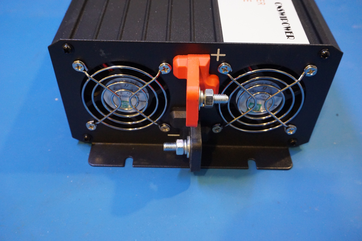

The version I received is a 12V one. The overall size of this inverter is only slightly larger than the 800W Reliable Electric inverter I have, coming at roughly 10.25’x6.5’x3.5′. It is however significantly heavier due to the additional components for the higher power rating. The case is made of extruded aluminum and it feels rather sturdy.
The front side of the inverter features two volt meters, one for displaying the current output voltage the other for displaying the battery voltage. There is also a remote control panel included in the package for fixed location installation.

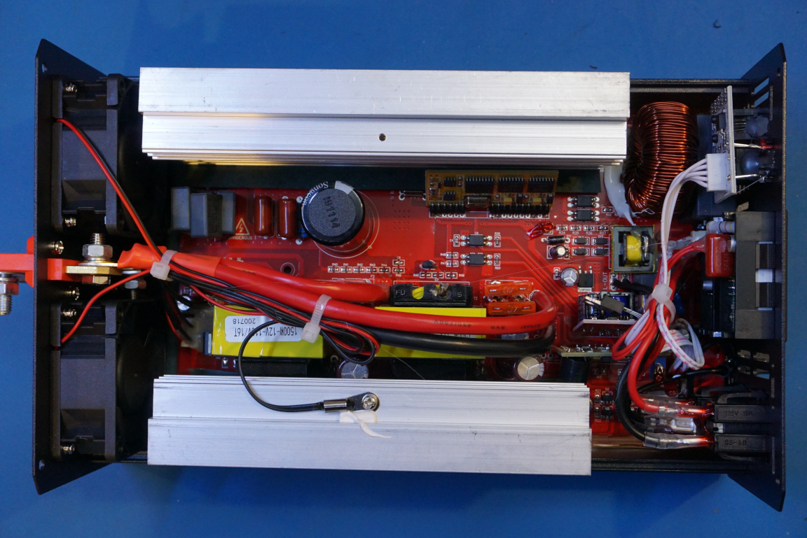

The case employees a clam shell design. Once the screws on each end panel are removed, the top cover can be easily removed. As you can see in the picture below, the overall layout inside is relatively clean.
Here is a picture showing the bottom side of the PCB once the board is removed from the case. Although there are mounting holes on the PCB, they are not used. Instead, the assembly is secured inside the case via a few screws between the case and the aluminum heat sinks on either side.
As you can see from the these pictures, the traces are heavily tinned to lower their resistances. Furthermore, additional wires are embedded in those high-current traces for added current carrying capabilities. This is not the cleanest design and also may not produce a consistent result due to the variance in soldering skills. For this kind of low input voltage high powered inverters, resistance along the high current paths play a big role in the overall system efficiency as at full output power over 130A of continuous current flows through the system and even one milliohm of additional resistance would mean over fifteen watts of wasted power.
Like most of these pure sine inverters, the main controller circuitry is contained on a riser board. According to the user manual, the main chip is a custom chip (an ASIC?). I assume that’s what that chip on the left in the picture below with no marking is. I could not find any information on the other two ID7S625 ICs either.
The overall design uses a DC-DC converter stage to first step up the input 12V into a higher DC voltage (around 170V or 340V depending on the output stage design) and then a PWM signal drives the output bridge to approximate a sinusoidal waveform. Finally, the waveform is cleaned by an LC low pass filter to form the final output.

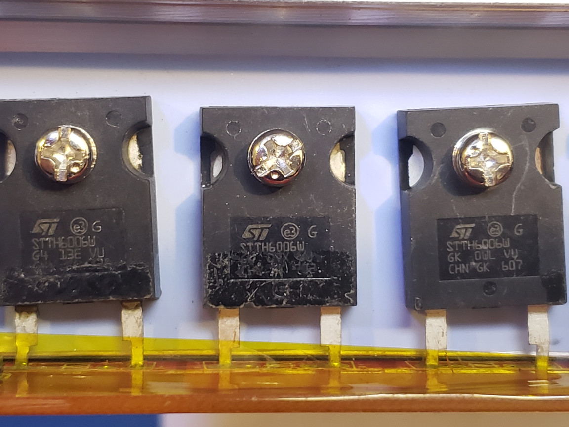

The picture to the left below shows the power devices used in the output bridge side. The picture to the right below are three of the four high voltage ultrafast diodes STTH6006W.
