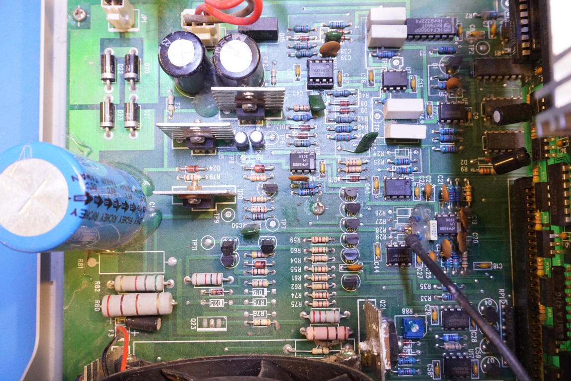

Here are a couple of pictures of the main board. Because the PPS 35-2 is a single channel version, only half of the circuitry is needed. As a result, the main board is slightly shorter than that in the PPS 2322 and there is no auxiliary power riser board. The main filtering cap is re-located to the main board thanks to the freed up space.
If you recall, in my teardown of the PPS 2322, three chips next to the process board socket had their markings sanded off. In this power supply though we can clearly see what these three chips are in the picture to the right below.
The two 16 pin DIP ICs are TC4015, dual 4-stage static shift registers. And the 18 pin IC to the right is an Analog Devices’ AD7541 12-Bit monolithic multiplying digital to analog converter chip (DAC).
There are a couple of bodged on resistors on the main board as can be seen below, looks like they are part of the differential input for the sensing circuitry.
