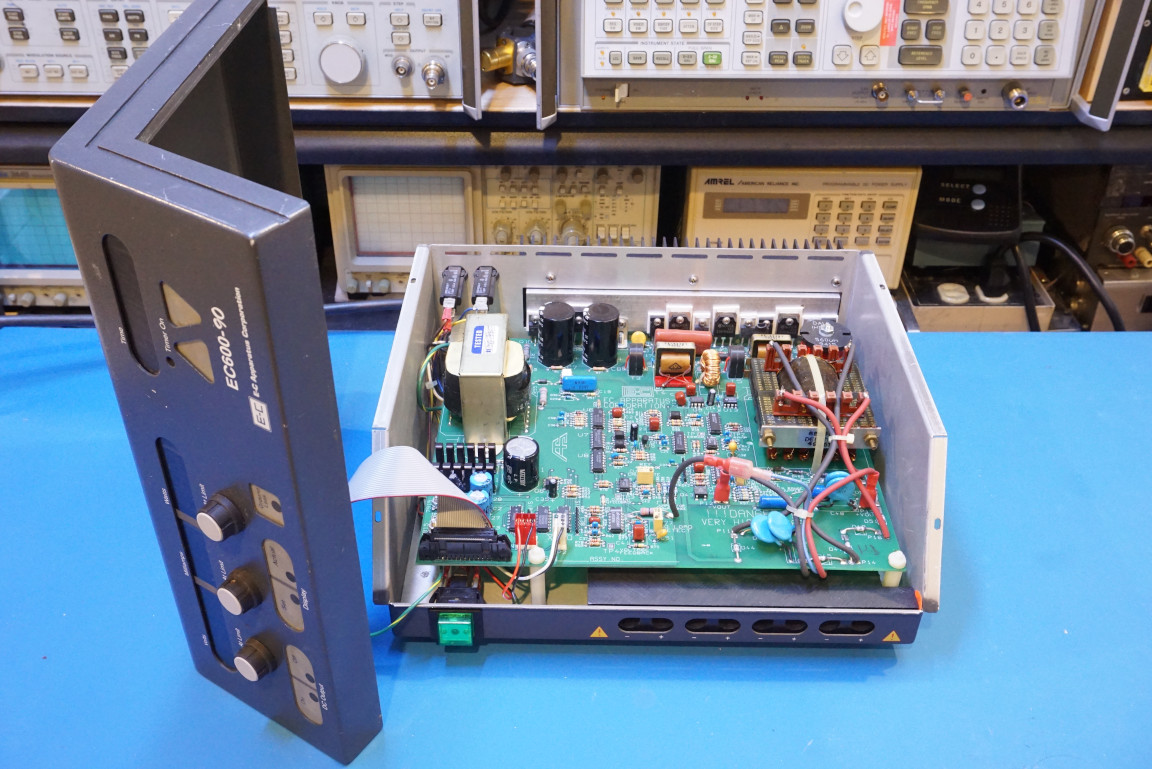

Now it’s time to take a look inside. The top cover is secured with four screws. Here is a picture showing the interior with the top cover removed. I really liked the design as the front panel is connected to the main board via a ribbon cable and it can be removed easily for servicing either half of the boards.

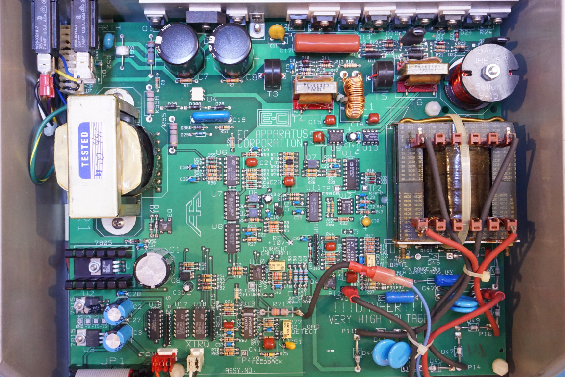

Here is a picture of the main board. While the exact topology of the power supply is not entirely clear we can infer from the TRIAC driver MOC3063 and the Thyristor 2N6344A mounted on the rear heatsink that this high voltage power supply utilizes TRIAC switching to achieve the variable output voltage.

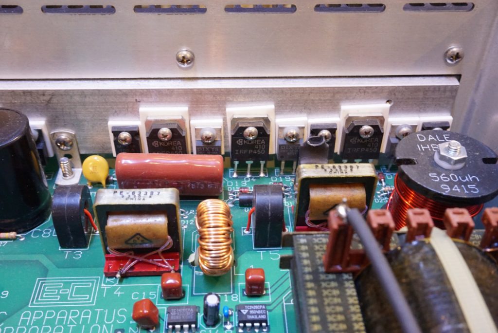

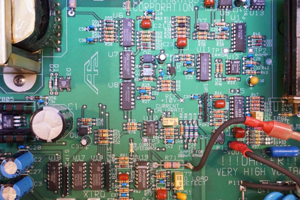

The MOSFETs used for driving the final inverter stage are IRFP450‘s, which have a Vds of 500V. The MOSFET drivers used here are TC1426CPA. There is also an LT1014DN quad precision op-amp, presumably used in the feedback loop to control the output voltage.
There is a a LM566 voltage controlled oscillator IC on the main board. Presumably it is used to generate the required pulses for the MOSFET inverter stage.

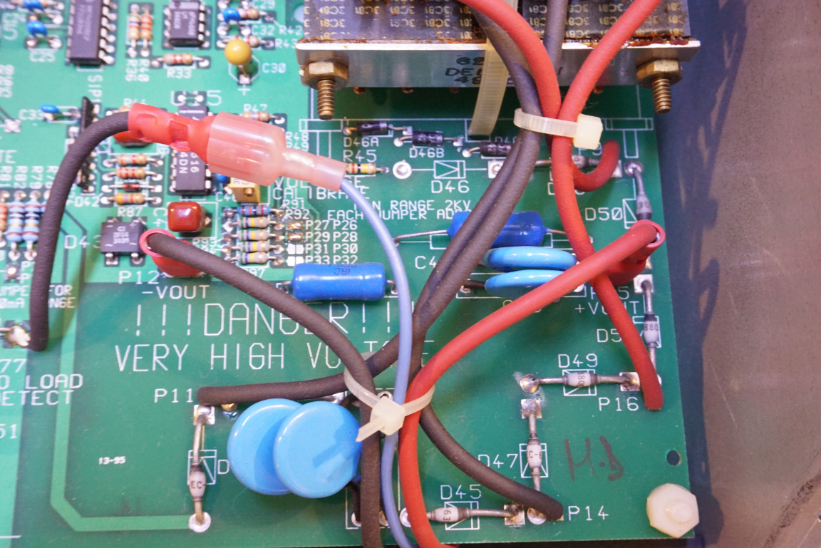

Here is a closeup of the high voltage output portion of the board. We can see many diodes connected in series so that they can withstand the high output voltage.

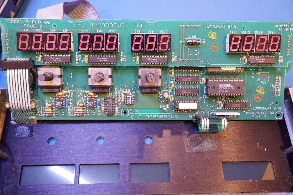

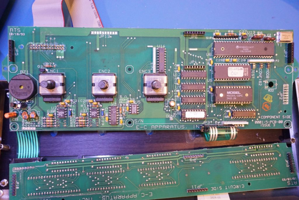

The pictures below are the front panel PCBs. There are two PCBs sandwiched together. The 7 segment display along with the MP14489 LED display drivers are on a separate PCB from the remaining front panel logic board.
The main front panel board to the right below contains a Motorola 68HC11 9bit microcontroller, along with SRAM (MS6264L-10PC) and the firmware EPROM. Three digital encoders are used for voltage/current and power limit adjustments.
Interestingly, there are a few AD654 voltage to frequency converter chips on the board. I am not entirely sure what they are used for. One possibility is that they are used as analog to digital converters. There is also a 12-bit digital to analog converter chip MAX543 in sight.

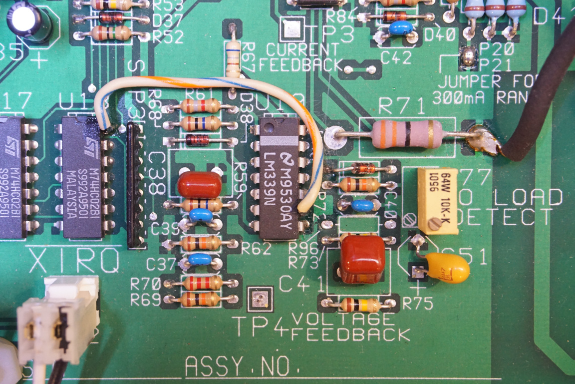

Now back to the load detection circuitry. If you look at the main board, you will see towards the bottom there is a section with the silkscreen “No Load Detect” printed. At the center of this load detection circuitry is an LM339 comparator chip.
After some testing, I figured out that comparator 3 (pin 8,9 and 14) of this LM339 is used for load detection. When load is present, the voltage drop across the sensing resistor raises the input on pin 9 above pin 8 and the output from pin 14 becomes high which in turn disables the no-load alarm. And when no load is present, the output from pin 14 is low.
To disable the no-load alarm, I simply wired the positive input to comparator 3 to an adjacent 5V rail, this overrides the sensing resistor input and worked out beautifully.
