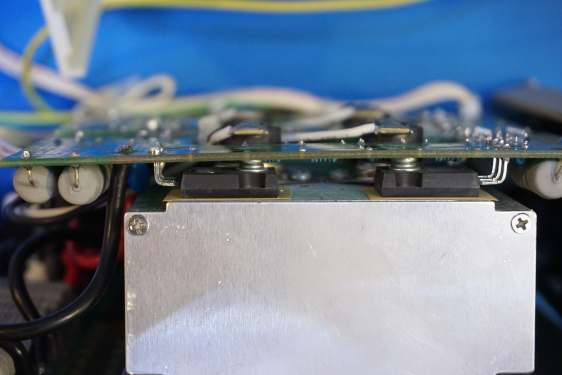

Here is a picture showing how the MOSFETs are mounted. They are folded over and soldered onto the board. This way, the space required for the power module is greatly reduced. I did not bother removing the MOSFETs off the heatsink and flip the board over as according to the schematics (they are included towards the end of the post), besides some resistors and a TL084 quad OpAmp which you can see from the picture to the right, there is not much else on this board.
