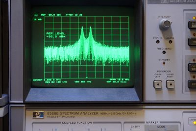

Frequency-shift keying (FSK) can also be accomplished by supplying two different frequencies to RF1 and RF2 ports. And by switching between these two ports the signal output from the center port becomes an FSK signal.
In the experiment setup below, the modulation signal from the Wavetek 395 is inverted using a simple transistor inverter (on the right) so the frequency content of the output can be switched between the two inputs by alternating the control signals.
For the experiment, a 2 GHz signal is taken from an HP 8671A RF synthesizer and a 2.001 GHz signal is taken from an HP 8642B, the two signals are 1 MHz apart.
The picture below shows the FSK spectrum (centered at 2000.5 MHz with a frequency span of 10 MHz) when modulated by an 1 kHz square wave. Note that because the two RF signals and the modulation signals are not correlated, the switching between the two signals happen at an arbitrary phase and this manifest as the increased phase noise in the spectrum.
And these two pictures show the FSK spectrum when modulated by a 10 kHz and 100 kHz square wave signal respectively. Again, notice the spread of the occupied bandwidth as the modulation frequency increases.
