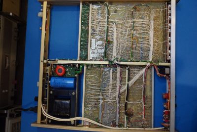

Upon opening the covers, we can immediately see the old school construction inside. Most of the ICs are 74 series TTL ICs. We can see the use of logical gates (74LS32, 74LS86, 74LS10…), flip-flops (74LS76, 74LS73, 74LS103…), counters (74LS193, 74LS192…) and decoders (74LS156, 74LS42, DM9374…) just to name a few. We can also find a few OpAmps presumably used for carrier frequency generation and modulation.
Every single one of the ICs inside this unit is socketed, making chip replacement a breeze.
The bottom side of the PCB looks stunning. Because of the IC densities on the PCB wire-wrapping techniques were used to make the various interconnects. Although the PCBs used here are double sided, it is apparently insufficient to route all the required connections within the PCB itself. The following are a couple of closeups of the wire wrap construction on the bottom side of the PCB. All the wiring is arranged meticulously.
Although wire wrapping has long become a thing of the past, these DIP sockets used for wire wrapping remain readily available among most suppliers.
Even the front panel 7-segment displays are socketed. A separate PCB for the display is then connected with the mainboard using right angle rigid interconnects. The level of attention to detail is quite astounding. Clearly, cost was the last thing went into consideration when this unit was first manufactured.
