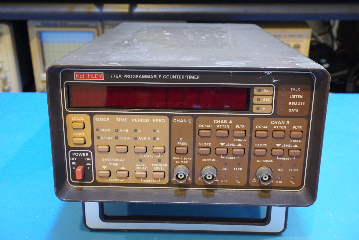

I just picked up a Keithley 775A programmable frequency counter from eBay. Specification-wise, this counter is very similar to the Racal Dana 1992 frequency counter I repaired last year. The Keithley 775A I got came with an additional channel (option 7751) and is capable of measuring frequencies up to 1.3 GHz.
Like the Racal Dana 1992 frequency counter, the Keithley 775A was also made in roughly the same era, back in the mid-80’s. In fact the specifications for these two frequency counters are very comparable with the Racal Dana 1992 slightly edging out in channel frequency coverage and sensitivity. Like the Racal Dana 1992, the Keithley 775A also has two channels that are designated for measuring lower frequencies (up to 120MHz for the Keithley 775A).

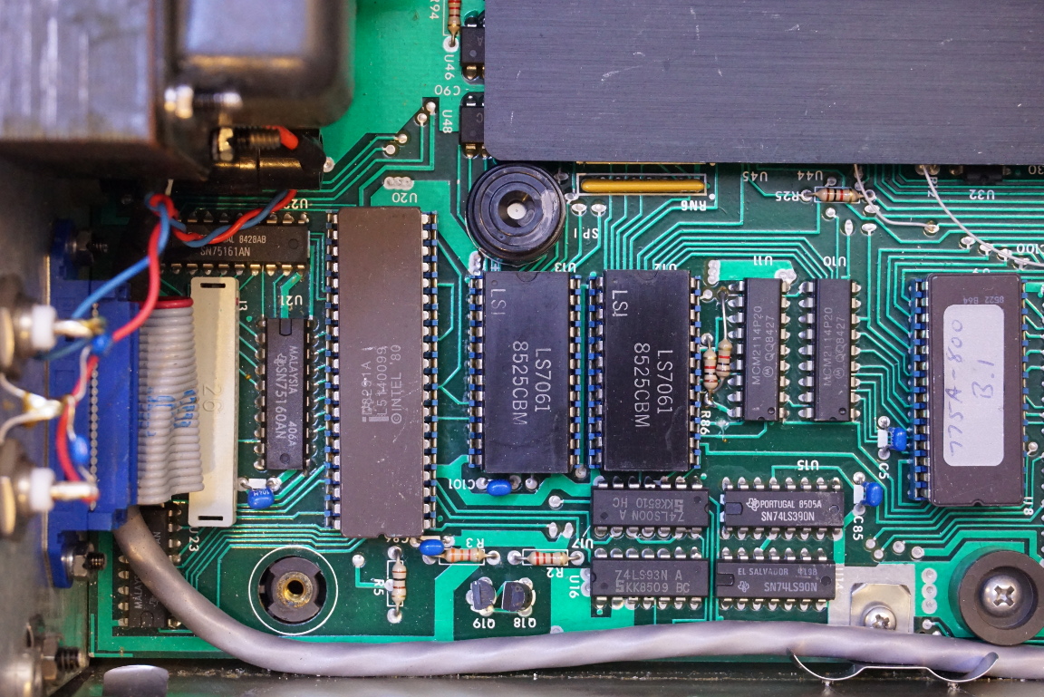

Next to the linear regulator section of the board lies the riser board for the TCXO option which this unit comes with. Unlike an oven controlled crystal oscillator, a TCXO does not use oven but rather senses the environmental temperature changes and compensates the oscillator circuit accordingly. Thus the frequency stability of an TCXO is not as good as that of an OCXO.
The GPIB communication is handled by an Intel 8291A GPIB controller. And the two chips located next to the GPIB controller are LS7061‘s which are dual 16-bit counters.
The firmware is stored in a 2674 EPROM.
The main processor used is an MAB8031A processor, which is essentially a ROM-less 8051. the display and keyboard logic on the front panel are handled by an M5L8279P-5 programmable keyboard/display interface chip.
