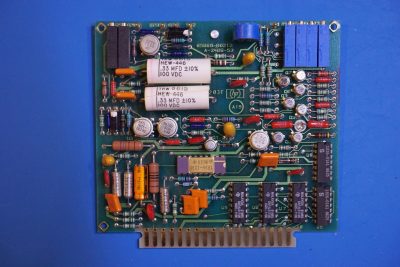

The remaining three plugin boards are the A21 FM coil driver, A20 YTO driver and A19 the digital to analog converter. The picture below shows the FM coil driver board. All the capacitors on this board looked fine and upon further testing all values and ESRs turned out to be within tolerance.

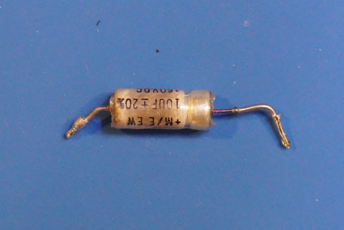

The board under the A21 FM coil driver is the A20 YTO driver board. Upon close inspection, one capacitor looked quite suspicious. I was very happy to see this as it further reinforced the theory that the YTO unlock issue was caused by some bad capacitors.
I desoldered this leaked capacitor and while its capacitance still measured at around 10µF, its ESR was more than 50Ω. So I replaced it with a 10µF 100V capacitor (the original one is rated for 60V) and hoping this would solve the YTO Unlock problem.
But it did not. The “YTO Unlock” message was still there when I powered up the spectrum analyzer with the cap-replaced A20 YTO driver board reinstalled.

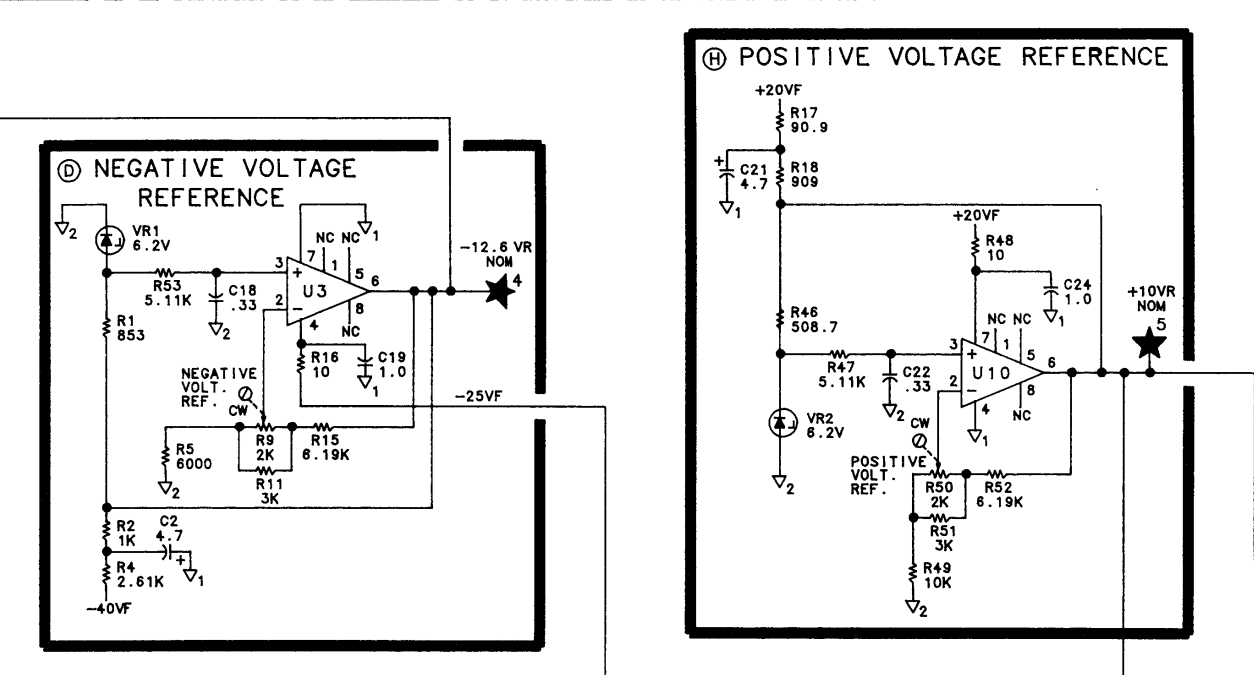

Then I remembered that while measuring various test points voltages, I came across the -12.6V on the A19 DAC board and it was only reading -12.4V. After reviewing the service manual, I realized that this value must be precisely -12.6V as this is the voltage used for YTO pretuning. So the 200 mV variation was simply too large for the tuning circuitry to compensate and thus causing the YTO to become unlocked.
So why the voltage was off from the -12.6 nominal value? As it turned out, when measured at the test point (TP4), the voltage reading seemed to drift a little bit. And while I was attempting to adjust the potentiometer, I noticed that the measured voltage jumped quite a bit. Sometimes by just applying slight pressure on the adjustment screw without turning it caused the measured voltage readings to jump wildly. So it became clear that the potentiometer must have failed due to its old age.
The potentiometer used here is a Bourns 2K low tempco (15ppm) one. And after I removed it from the board I confirmed that the wiper indeed was not making good contact. So I opened it up and was hoping I could clean it and repair it. From the picture below you can see that the surface of the potentiometer was badly scratched up. Unfortunately, the resistive film on the substrate is very thin, even gentle cleaning caused the resistive material to flake off.
Since I didn’t have any precision potentiometers of the same kind lying around I had to substitute with the components I have. Looking at the circuit diagram though, it seemed that the actual value of the potentiometer is not super critical, as it was simply used in the feedback loop of the non-inverting amplifier to obtain the -12.6V from a 6.2V Zener diode. So I ended up using a cheap 5K 10-turn trim-pot paralleled with a 3.3K resistor as the replacement. This way although there is a bit more non-linearity introduced the overall resistance stays at roughly 2K. Even without the paralleled 3.3K resistor the replacement probably would’ve been just fine.
I also painstakingly measured every single capacitor’s ESR on the DAC board. And while the ESRs all measured good, the capacitor connected to the positive input of the negative voltage reference OpAmp (C18) seemed to be a bit low. I am sure I could have just left it as is since its value has little impact on the performance of the OpAmp. But I replaced it with another one just in case problem develops down the road.
Here is a picture of the board after the potentiometer and the input capacitor had been replaced.
After replacing these components, the YTO unlock error was gone and my HP 8566B was back in working order again. I left the unit on overnight to see how stable the -12.6 V was and even without the low tempco potentiometer the voltage variation stayed well within a few mV. Although I might change the potentiometer to a proper low tempco one like the original one sometime later, the spectrum analyzer is fixed for now.
