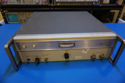

In my previous video featured on EEVBlog I did a teardown of an HP 493A microwave amplifier along with the traveling wave tube inside. I actually had done a teardown of an identical unit a while ago but this time I managed to take a peek at the traveling wave tube inside.
This unit looks slightly older than the one I did a teardown with back in 2014 and is missing a couple of components in the high voltage section so it no longer work. Generally I hate to do any destructive teardowns, but the traveling wave tube inside this unit has long passed its prime time (I tested it by swapping the traveling wave tube with my working unit and it turned out to be very weak) so I thought it would be a great opportunity to take a look at its construction.
The main active circuitry inside this TWT amplifier is a high voltage regulator board (on the left) for the traveling wave tube and a modulation board (to the right) if a modulated output signal is desired. At the heart of the high voltage regulator board are three 8068 beam pentode tubes.
