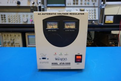

I bought a used RegVolt ATVR-1000D automatic AC voltage regulator (the model I got has long been discontinued, but you can find a current production model here) off eBay last week. This regulator was produced for the 110V market, but I suspect that with some adjustments I could get it to output 120V instead.
The ATVR-1000D utilizes a motor to drive the wiper of a autotransformer (Variac), the servo motor can be driven in either direction depending on the output from the OpAmp (LM324) based comparator. Comparing to a voltage regulator that uses relays for tap-switching, this type of servo-driven voltage regulator has several advantages. It offers continuous voltage adjustments as opposed to the limited discrete steps offered by relay-switching regulators. Also the output waveform is continuous. As unlike relay switching in which the contacts were disconnected first before a different tap was chosen, the carbon wiper maintains contact with the transformer coil at all times. The main drawback of this kind of motor-driven voltage regulator is that its reaction speed is relatively slow (the rated response time for the ATVR-1000D is 1.5 sec) due to the mechanical constraints. Thus it is only suitable for maintaining slow-varying line voltages.
