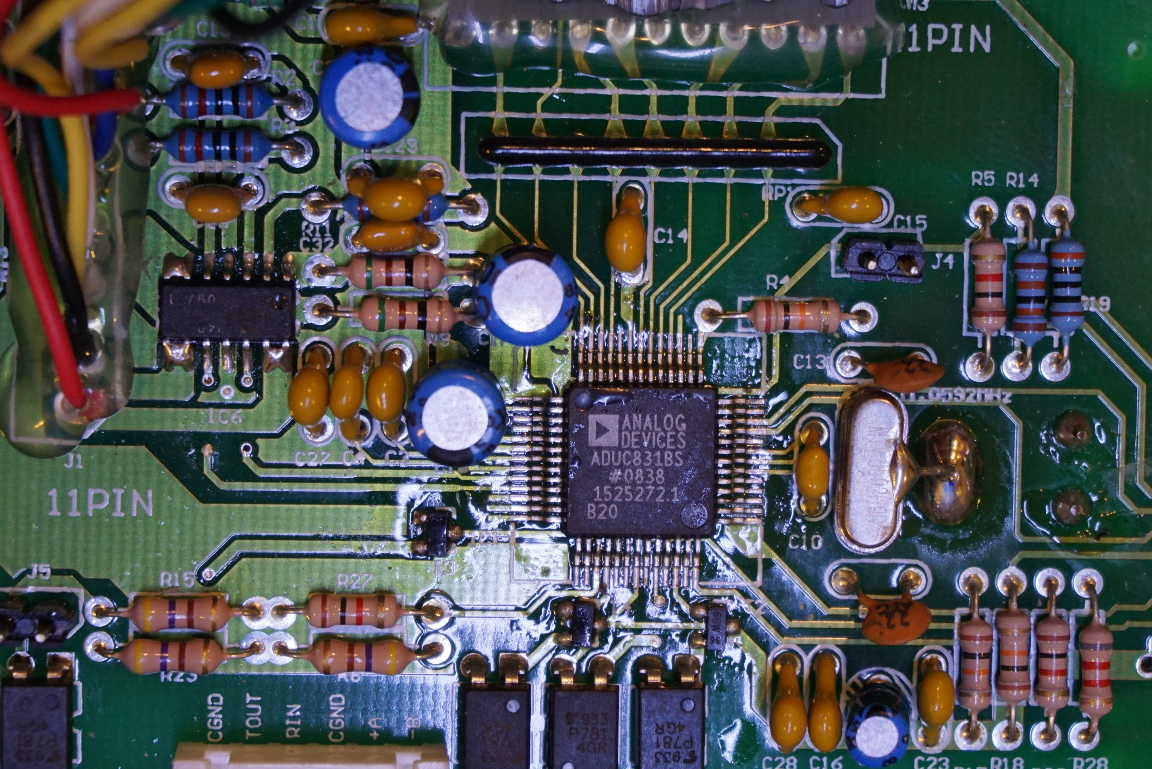

The picture below is the board mounted on the front panel. It houses the digital control logic. Towards the bottom you can see that signals are outputted to an RS-485 port and an RS-232 port via opto-isolators. The controller chips used are MAX485 for the RS-485 and MAX202CPE for the RS-232. An eight channel analog multiplexer/demultiplexer chip CD4052BC is also used here.
The microcontroller used in this programmable power supply is an ADuC831BS. It is actually a very potent 8051 chip with multiple 12-bit ADC’s and DAC’s. And the LCD driver used is a NJU6433F, which uses I2C protocol and drives the individual segments on the LCD. (Correction, it is not I2C, but rather a serial protocol that is similar to SPI).
