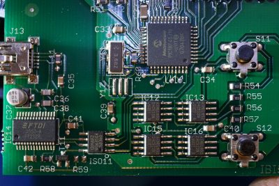

The digital board can be easily accessed. It is based on a Microchip’s PIC18F45J10 microcontroller. This is a rather beefy MCU. It has 32K flash memory and 13 10 bit A/D channels. UART, SPI and I2C are all supported in hardware. Judging from the location and the pin connections of the MCU, I think it is primarily used to drive the user interface (e.g. the tactile switches and LCD). So clearly, the power measuring task is handled elsewhere.
Here is a close up picture of the digital board. As you can see, four 64K 24C512N EEPROMs are used for information logging. Depending on the frequency and number of data points chosen, the Watts Up? Pro ES is capable of logging continuously with hours to days worth of data points.
Since Watts Up? Pro allows communication with a PC via USB while it is plugged in, it utilizes an ADuM1201 dual channel digital isolator IC from Analog Devices for galvanic isolation of the Rx and Tx serial lines. Without this isolation, you could easily destroy the connected device and/or the power meter itself while doing measurements. For instance, if you try to measure the PC’s power consumption while logging to the same PC via the USB connection. The serial to USB conversion is handled via the venerable FT232RL.
