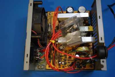

Some power supplies however, do not use dedicated power supervisor chips but rely on some other techniques for over-voltage protections instead. In the power supply I have (a rather generic DURO 400W power supply manufactured in 2003) for example, over-voltage protection is achieved by pulling the deadtime control pin on the PWM IC TL494 high when over-voltage is detected which effectively increasing the deadtime to 100% and thus disabling the output transistors. This technique is commonly used with PSUs that use TL494’s for regulating the output voltages.
To disable the over-voltage protection, we can simply cut the trace from the DTC pin (pin 4 of TL494, see schematics below) and put a 3.3K resistor (R4) between the DTC and ground. The value of the resistor is not critical. Because the DTC pin is no longer connected to the voltage comparator circuitry that monitors the output rails, we can proceed to adjusting the output voltage.

Since we only care about the 12V rail voltage, we can simply lower the value of R2 by paralleling a resistor R3 till the desired output voltage is reached. For this PSU, I used 15K for R3 to achieve the 14.6 output voltage.
And here are a couple of pictures showing the added resistors to the PCB. In the picture to the right, you can clearly see the trace connected to pin 4 of TL494 was cut. In the picture the lead of the 15K resistor seemed to be nearly touching pin 2 of the chip, this is due to the angle of how this picture was taken. In reality the lead is pretty far from that pin. If you are worried about accidentally shorting out the pins, you can use some heatshrink tubing here.
