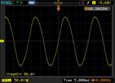

I measured the 120V AC output waveform when no load is attached. The measured sine wave is shown below. As you can see, the sine wave is very clean. Note that the voltage readings below are roughly 10% off due to the extra resistor placed between the probe tip and the output socket for added protection.

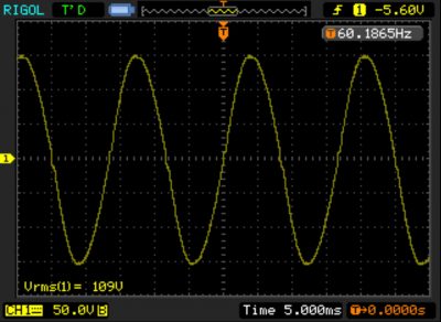

The following two oscilloscope captures show the waveforms when the inverter is under load. The one on the left shows the waveform when the load is 200W. And the one on the right shows the waveform at 400W. Again, the waveforms are quite clean although there is a tiny bit of distortion around zero crossing when the load was increased to 400W. The load I used in the load testing was a resistive heater with the power consumption adjusted using a VARIC (autotransformer).
As the load increases, the distortion becomes more noticeable. Here are two oscilloscope captures showing when the load was at 600W and 750W respectively. Even at near the full load, the waveform quality remains quite acceptable. The output line voltage remained stable under load and only dropped to just below 110V when the load was increased to 750W.
