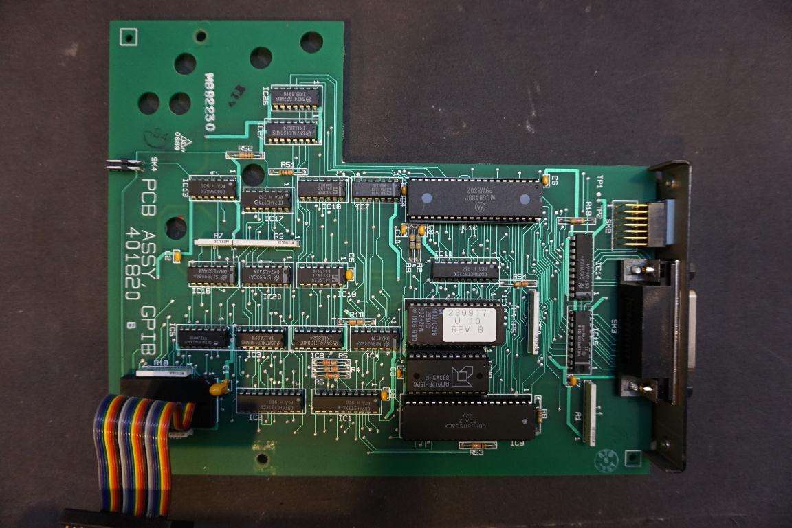

The GPIB board uses an Motorola MC68488P general purpose interface controller chip along with a CDP6805 microprocessor. The integration level of the GPIB board is quite low. The bottom side of the main PCB can be seen from the picture to the right. The input circuitry for channel A and channel B is shielded to prevent interference. The area where the mains enters the board is also covered to reduce the risk of electrical shock during servicing.

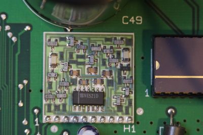

Here are a couple of closeups. The ceramic chip AD9687 is a dual ultra-fast ECL-output comparator. The image on the right is a NE521 high−speed dual−differential
comparator board. Again, all the resistors are printed onto the board.
