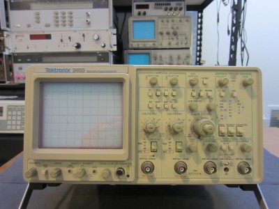

Today at a time when digital storage oscilloscopes (DSO) are almost ubiquitous, analog scopes like Tektronix 2465 remain popular among many electronics hobbyists, especially among amateur radio operators who routinely work with high frequency circuits. I got my 2465 from ValueTronics. For those who haven’t heard about them, I would recommend you check them out as they have a large selection of used test equipment at reasonable prices.
When Tektronix first introduced this oscilloscope back in 1984, it cost a fortune. Now thirty years later, anyone who wants to own a fine analog scope can get his hands on one. At a price of several hundred dollars, very few oscilloscopes (used or new, including modern DSOs) can match its 300 MHz bandwidth and advanced triggering capabilities.
In the picture below, you can see the 4-channel 300 MHz Tektronix 2465 in the foreground. The oscilloscope on the top in the background is my 150 MHz Tektronix 2445, which looks almost identical to the 2465 except that its horizontal sweep rate goes from 1s/div to 10ns/div instead of the 0.5s/div to 5n/div range on the 2465.
The 2465 has four independent channels. Chanel one and channel two have independent vertical deflections range from 2mV/div to 5V/div in 11 steps via processor-controlled attenuator networks. The inputs into these two channels can be configured as either AC coupled or DC coupled with an input impedance of 1Meg or 50 Ohm (for DC coupling only). The 50 Ohm input impedance option is extremely useful when measuring various RF circuits as proper termination is usually required.
Channel three and channel four use fixed attenuators with two gain settings. These inputs are DC coupled with 1 Meg input impedance only.

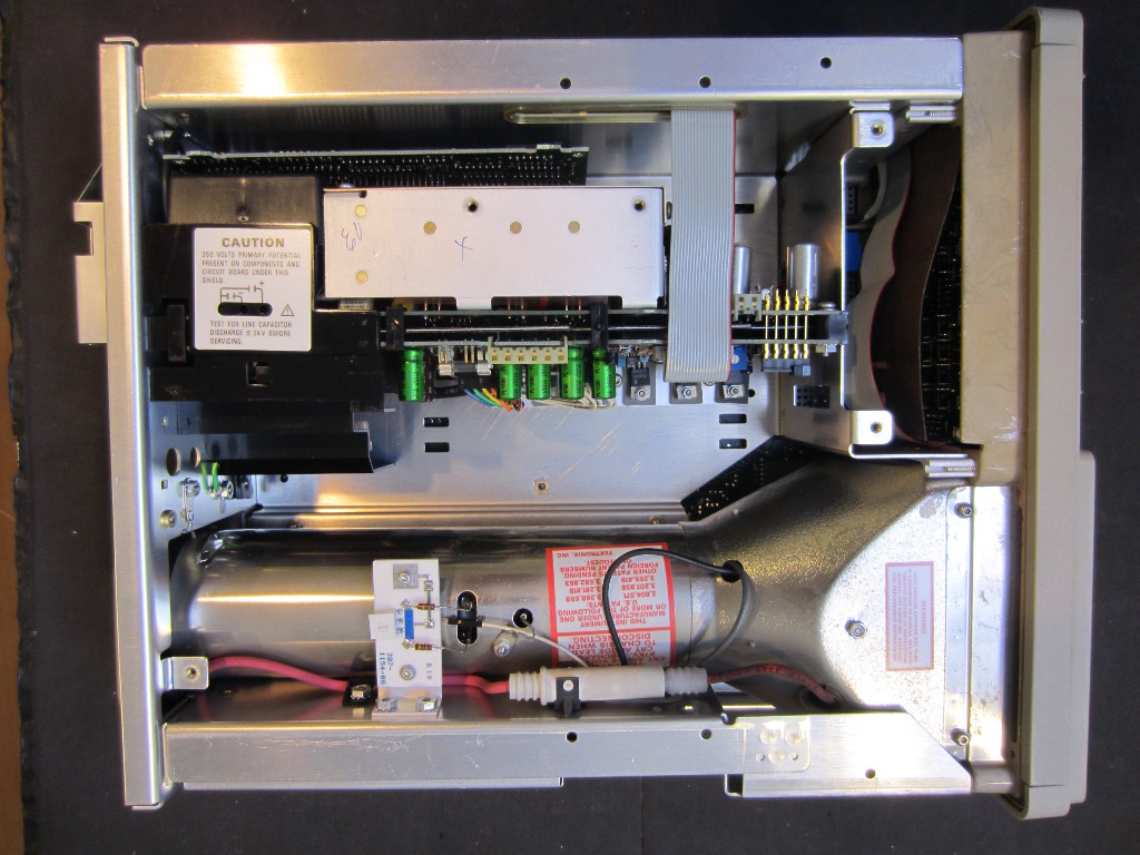

Here is a picture showing the top aluminum plate after the case has been removed. This cover is more for safety considerations than for shielding purposes as dangerous voltages exist in the the switching power supply and the CRT circuitry underneath.
The picture below shows the interior of the scope with the top aluminum plate removed. Towards the middle you can see the A2 regulator board and the A3 inverter board. Together, these two boards provides all the regulated low voltage rails used throughout the system.
A switching power supply is used in this scope so no bulky mains transformer is present. The switching power supply circuitry is located under the aluminum cover towards the top part of the chassis.
