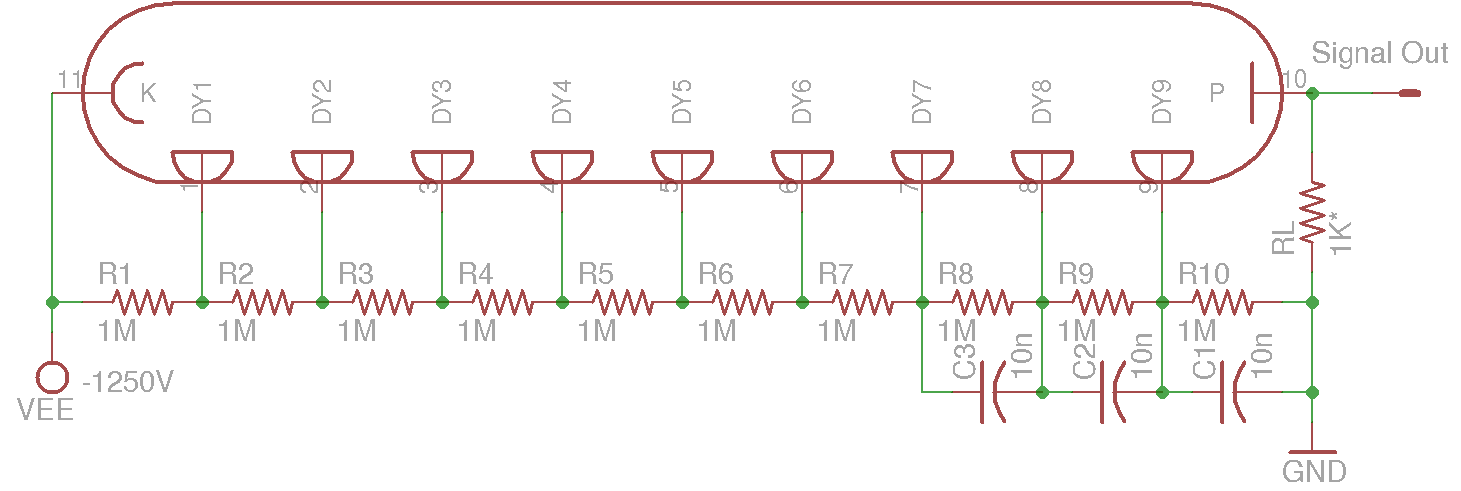

The circuit diagram below shows the actual detector circuit I used in the speed of light measurement experiment. The voltage divider resistors were changed from their original 3MΩ values used in the PM2L color analyzer to 1MΩ to increase the light current output and thus increase the detector sensitivity.
PMTDetector
Three capacitors at the last three stages of the photomultiplier are used to improve the output signal linearity for short duration signals and in our case, these bypass capacitors help to maintain an output light current during the short duration pulses. The current generated during these short pulses can be higher the current that can be provided by the resistor divider because of these capacitors and thus the sensitivity of the detector is also improved.
For ideal pulse shapes, the load resistor should be 50Ω, which matches the output coax connection impedance. For this experiment though, I chose a slightly higher valued resistor (1KΩ) in order to make the generated load voltage larger for easy measurements. This nevertheless affects the output signal quality to some degree as you can see the ringing in the observed PMT output traces below.
