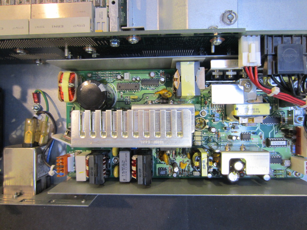

Like many test gear made back then, the entire case was made of sheet steel. So the case is very sturdy and can definitely survive a few feet drops. But on the other hand, these cases are extremely heavy. In the pictures below, you can see the switching supply PCB board and a closeup of the output terminals. The 3.3V rail supplies most of the power and the rated current for the 3.3V supply is 80A.

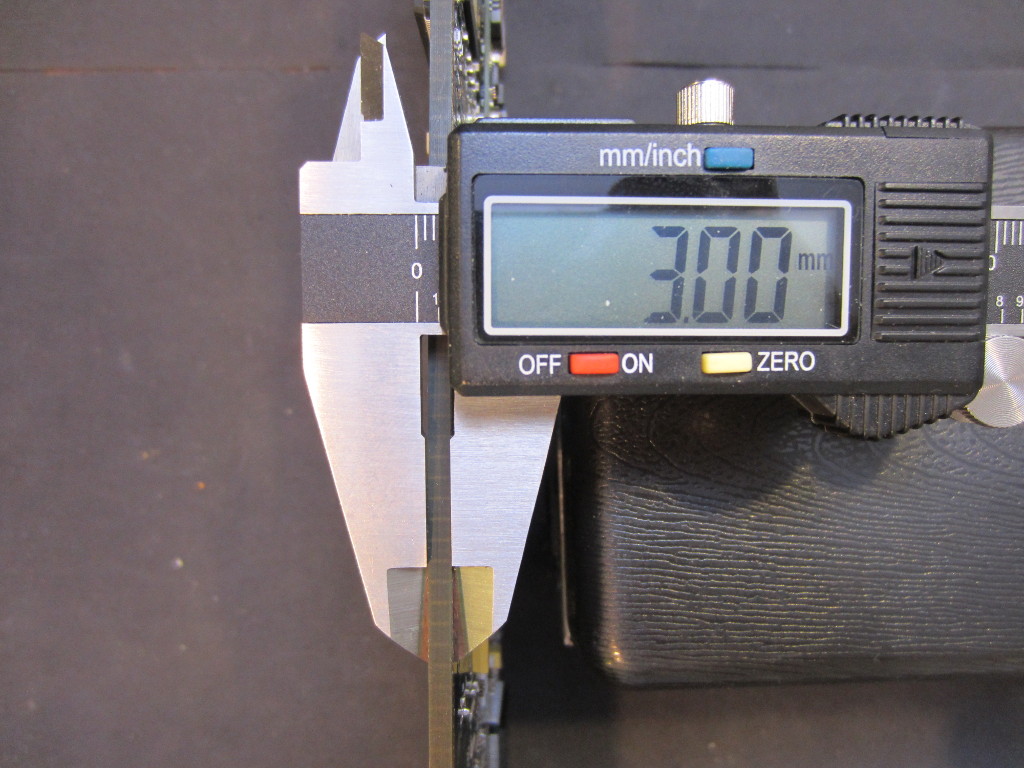

Like the internal mounted modules, all the plug-in modules are mounted using the same mechanism. The board shown below is the 8-port ethernet switch module. This module and the fiber channel module you will see later on were both assembled on 22-layer PCBs. I had seen boards with up to 18 layers before but this is the first time I actually saw a commercial product with a 22-layer board. The final PCB is quite thick (3 mm) due to the large number of inner layers.
The reason for this high layer count is partially due to the strict timing and signaling requirements of the two FPGAs (the ethernet module has only one FPGA but the fiber optics board has two). On the ethernet module we can see a PMC ClassiPi PM2329-BC packet content classification processor, a Xilinx Spartan II family FPGA XC2S30 and an Intel LXT9875 fast 8 port ethernet transceiver chip. We will take a look at those heatsinked chips a bit later.

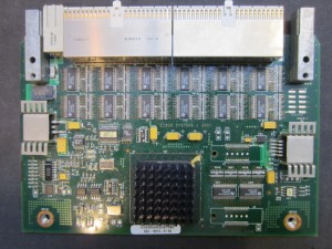

Each of the three boards shown so far has a heatsinked MOSFET. The PCB alone is not enough to handle the heat dissipation so a separate heat sink is added. Take a look at the heat sink, it does not make contact to the surface of the MOSFET directly. Rather, it is soldered onto the PCB and transfers the heat out directly from the metal tab of the TO-263 SUB75N03.

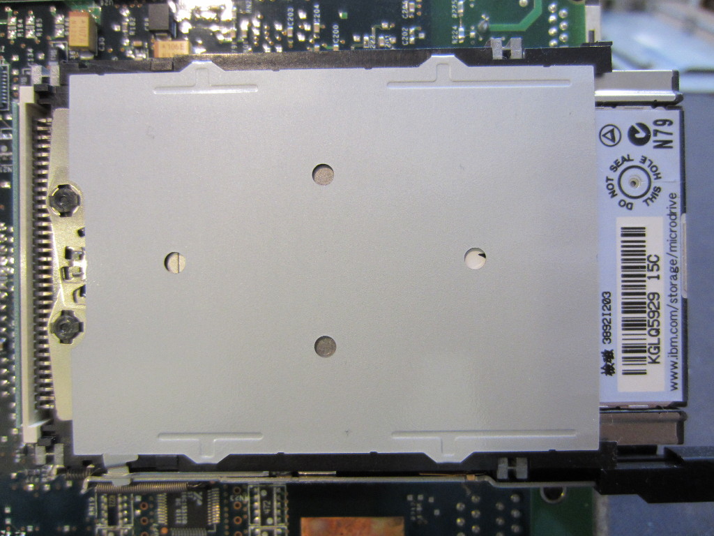

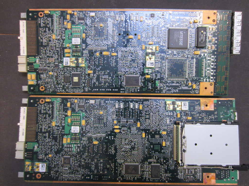

The following are pictures of the underside of the fiber optic networking module. Two PCMCIA slots are available and hence the need for a ISA to PCMCIA bridge we saw earlier. In the closeup picture, we see a couple more DC-DC converters next to a PIC16FL877 microcontroller.
From the picture on the right below you can also see that the IEC connector is press-fitted not soldered. In fact most of the connectors inside this Cisco unit are press-fitted.
Here is a close look of the PCMCIA bays and the 512 MB IBM microdrive.
As I mentioned earlier, these boards are 22 layer PCBs. This can be verified by the markings towards the edge of the PCB as shown in the pictures below.

Here are a couple of pictures showing all the boards inside this Cisco switch. I had also removed all the heatsinks so we could see the other chips used. On each board, the two heatsinked ICs are a VITESSE VSC2100 packet processor (on the fiber optic board the processor is a VSC2102) and a PMC RM7000A-400T dual issue symmetric superscalar microprocessor. The chip on the smaller PCB is a VSC2708 8 port switch.

Finally, let’s take a closer look at the switching power supply used here. This is power supply was sourced from ASTEC, it can provide 80A on its 3.3V rail!
So if nothing else, this switching power supply can definitely be used in another project.
