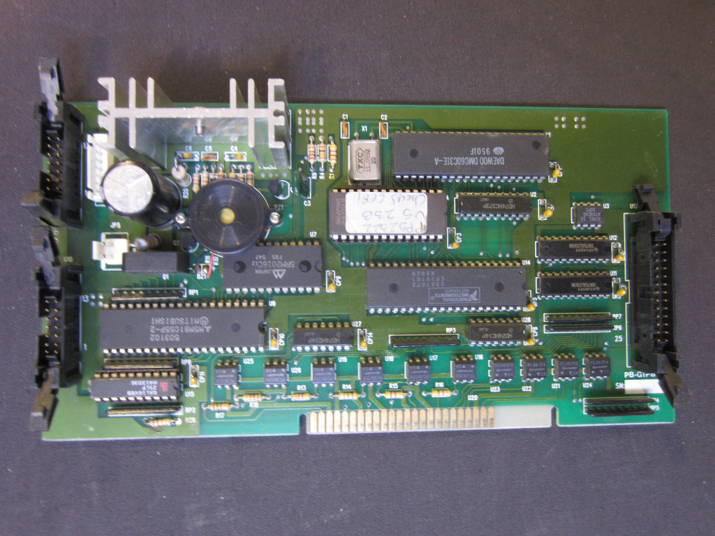

The picture below to the left shows the interior upon removing the case cover. As you can see the layout is rather clean. The main board at the bottom handles all the analog stuff and the plug-in processor board handles the programming and GPIB communication.
The processor board contains a CPLD (GAL16V8B) chip, two SRAM chips (MPM81C55P-2 is a 2K SRAM and SRM2016C is a 16K SRAM), and a 80C31 microprocessor (DMC60C31E-A, which is essentially a ROM-less 8051). The NI chip (CP19161) is presumably the GPIB controller (although I could not find any information on this chip). The firmware is stored in the UV-erasable EPROM (the firmware version of my unit is 5.23B).
Everything on the digital board is powered by a linear regulator 7805. The entire processor board is isolated from the remaining power supply circuit via an array of optocouplers.

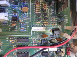

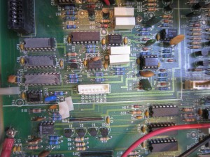

The two pictures below are the closeups the main board. In the left picture you can see one of the 74HC14 was not seated properly before soldered, similar to the problem we saw earlier on the processor board. And in the picture on the right, you can see all those 4N35 optocouplers similar to what you saw on the processor board. In a lab-grade programmable power supply, opto-isolation is critical as you do not want the power circuitry to destroy your entire system during a malfunction.

In this portion of the main board, you can see three ICs with markings sanded off. I am not entirely sure what these three chips are used for here but clearly it must be something Amrel thought was important enough to put the effort in to obfuscate.

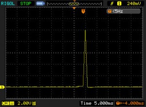

The oscilloscope capture below are the power-on and over-current protection characteristics. The power on voltage curve is nice and clean and over-current cut off looks quite excellent as well.
PPS-2322 also has over-voltage protection capability. Here is an oscilloscope capture of the OVP in action. The output voltage was set to 12V and the OVP level was set to 10V. The output was initially turned off and the waveform was captured when the output was switched on. As you can see when the voltage reached to around 10V, the output was automatically cutoff. The entire process took less than a couple of milliseconds.
