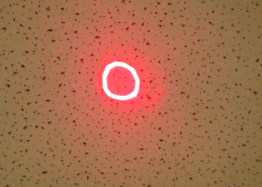

Due to the added mass, the optimum operating frequency of the speakers are well below 500 Hz. I chose 100 Hz for the x-axis rate. The output volume is adjusted so that the scan line remains flat when no signal is present at the y-axis.
The signals I used for both x-axis and y-axis are sine waves, so this configuration is similar to the x-y mode of a typical oscilloscope. In the Lissajour curves below, the pictures are for the y-axis frequency of 50Hz (1:2), 100Hz (1:1), 200Hz (2:1) and 150Hz (3:2).
