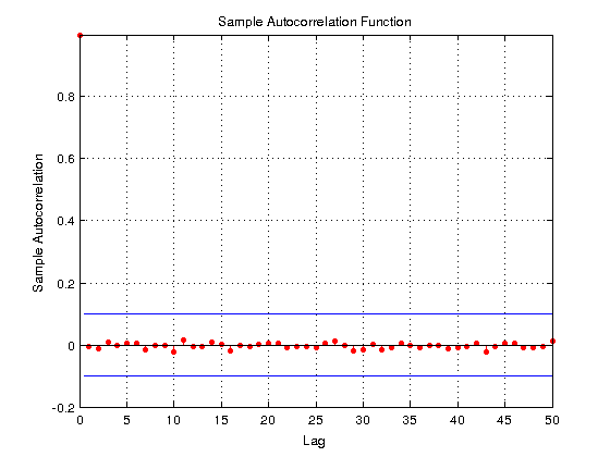

The first figure shows the autocorrelation of the random number series when 1000 samples are used. The second figure shows the autocorrelation when 10,000 samples are used. As more samples are used, the autocorrelation of the sequence across different lags slowly converges to zero, indicating that the sequence is independently and identically distributed.
Here is the autocorrelation plot when the entire sample sequence (1 million) is used. As you can see, the autocorrelations are virtually zero across different lags.

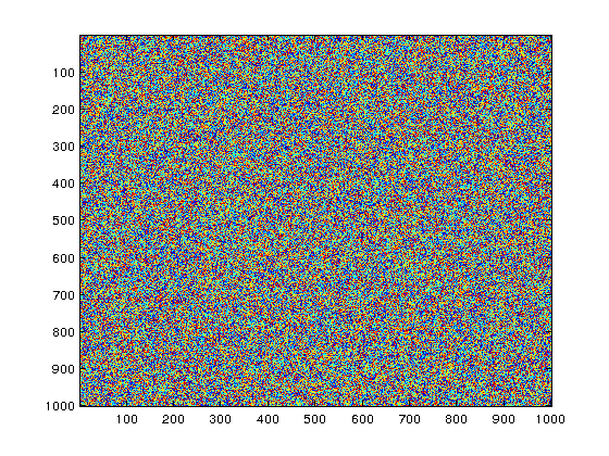

Here is another visual representation of the 1,000,000 sample data from the TRNG. The data is arranged into a 1000×1000 matrix and the color indicates the magnitude of the value at that point:
