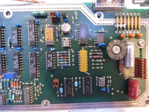

A3 Processor/Memory Module
A3 module sits near the front panel and is pretty easy to remove.
The crystal oscillator frequency used here is 5 Mhz. Take a look at the chip to the upper left of the main processor, the way it is heatsinked is rather interesting.
Here is a picture of the backup battery. It is used to retain the settings in the RAM when power is lost. The battery is rechargeable (rated at 45 mAh). Since these units are designed to be plugged in all the time, the battery is designed to last only a short period (e.g. several days) before it is depleted.
A4 Latch Module
Like A3, the layout of A4 is also pretty standard, just like how most digital boards’ layout back in the 80’s. Since the speed of these digital boards are relatively slow (under 10 MHz), propagation delays are negligible and trace routing is not super critical.

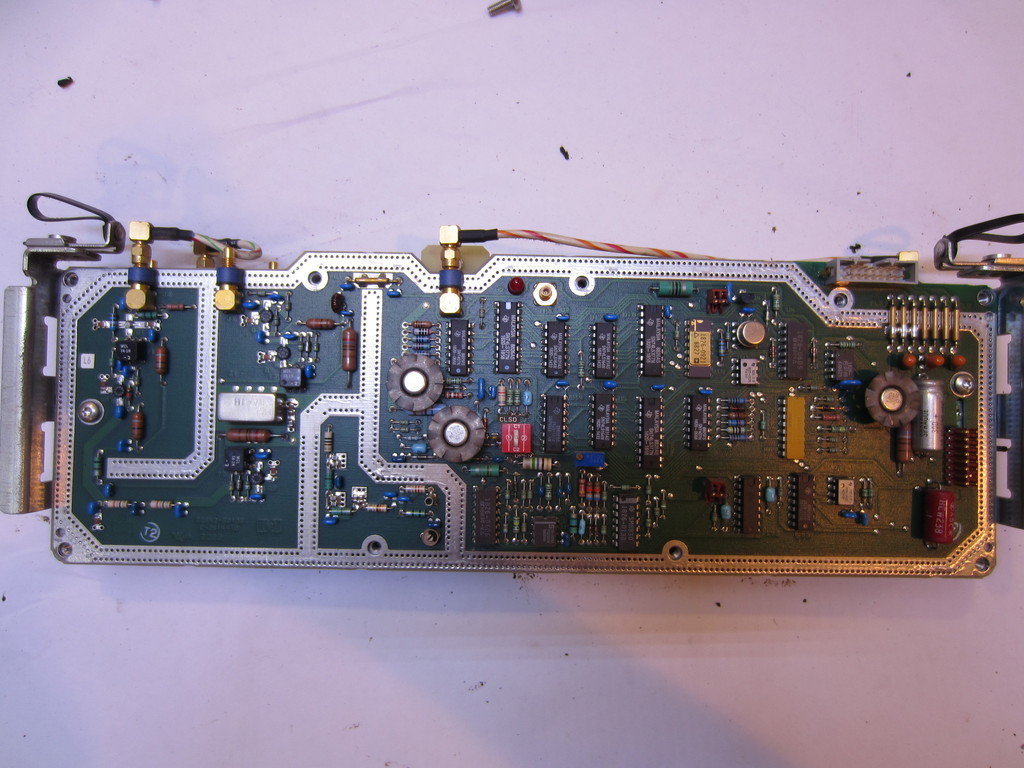

A6A1 FM Loop/Counter/Timebase Module
This is the first shielded module. Each side of the module is shielded via a different piece of metal enclosure. From the images below, you can clearly see the heavily via-stitched ground traces. These traces make contact with the springy contacts inside the metal cover (you can see a couple of pictures towards the end of the post) which ensure good electromagnetic shielding.
In the last picture above, you can see how signals are brought in and out of the board (via shielded lines). This technique is used throughout the high frequency sections to avoid any disturbance to the continuous ground plane.

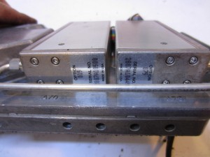

The high stability crystal oven lies beneath A7 and A8. In one of my previous posts, I did a teardown of the crystal oven inside the HP 5350B so I did not bother take this one out.

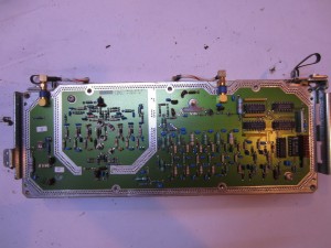

A11A1 Reference Loop Module
In this module we are going to see some RF magic. On A11A1, the left side is the RF portion and the right side is the digital portion.

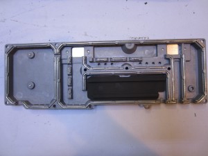

A11A2 is dedicated to the RF stuff. You can clearly see a few distributed element filters in the pictures below. The center filter element is custom-made onto a separate PCB (presumably different material characterized for high frequency use). And it is a critical portion of the reference loop and thus additional shielding is introduced (see the conductive foam under the shielding cover).

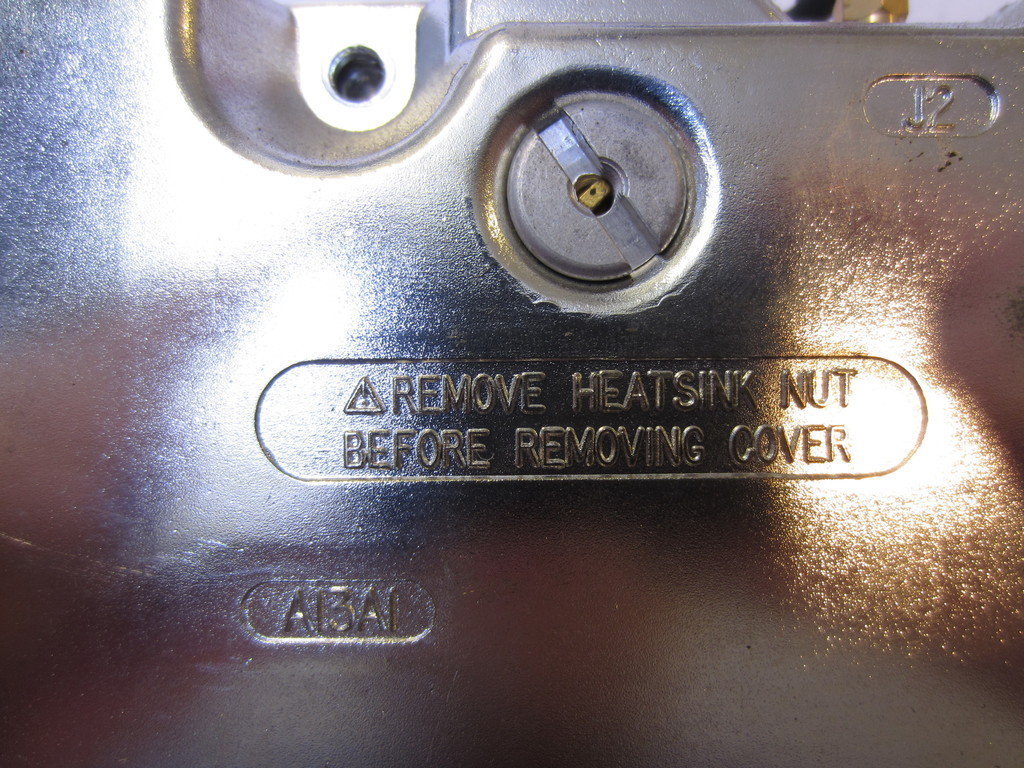

A13A1 Output Filter/ALC Module
You will need to be careful when opening up the shielding case on both A13 and A14 modules as they have heatsink nuts screwed on them. In order to open the case these nuts must first be removed. On A13, the heatsink nut is attached to the RF power amplifier module on the A13A2 board.

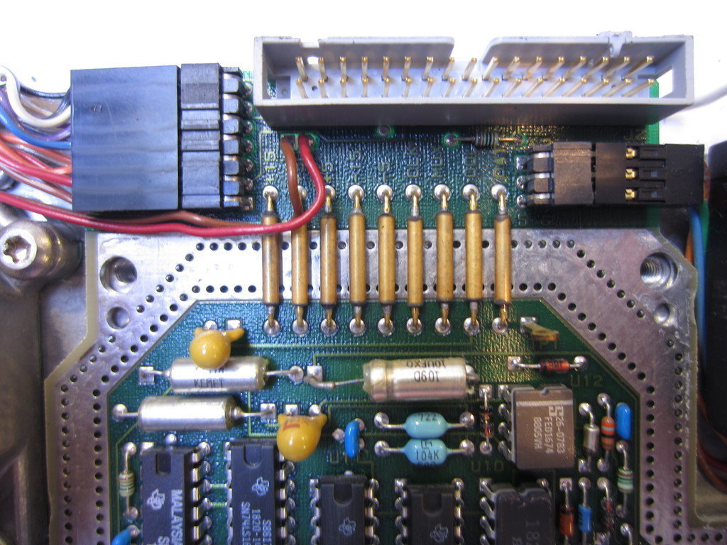

Here is a close up showing how signals are brought into the ground-plane-enclosed area via feedthrough capacitors. The outside of these capacitors is grounded and sealed off via the matching grooves on the shielding cover.
