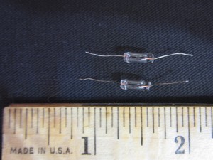

The original HP 8642 series used two miniature incandescent light bulbs for the instrument LCD backlight and the backlight has an orangish color to it. Unfortunately these light bulbs do not last that long (a few hundred hours) and if you got a used HP 8642 chances are that the backlight no longer works. This is exactly what happened to my HP 8642B. Unfortunately, without the backlight the instrument display is pretty difficult to read. So I decided to open it up and change the backlights.

These incandescent lights are very tiny and are soldered directly onto the board. They are spec’d at 5V 115mA and can be turned on and off via special functions 134 and 234. While these miniature incandescent bulbs can still be purchased, I decided to change them to LEDs as these incandescent lights are typically only rated for a life of several hundred hours and it is such a pain to change them.
So for this mod, I used a Dremel to sand down a couple of 5mm bright white LEDs so that they can be wedged into the same space where the original bulb sits. The leads were bent right at the base as otherwise they would interfere with the two pushbuttons (LOCAL and MSSG) on each side. A 120Ω current limiting resistor is used to drive each LED, given the 5V supply voltage the current is around 10mA. I could have just soldered the LEDs at the same spot where the incandescent light was placed and use the special function buttons to turn them on and off. But since the display is actually quite hard to see without any backlighting, I decided to make the backlight permanent by soldering the LEDs directly to the 5V supply to the A1A2 board:
The power to the LED on the other side (not shown) is tapped off the 5V supply to the μPD7225 LCD controller. The acrylic light guide underneath the LCD does an excellent job at evening out the light. If you like blue backlight, you can use blue LEDs for this mod. But personally, I think white backlight provides the best contrast for easy reading.
