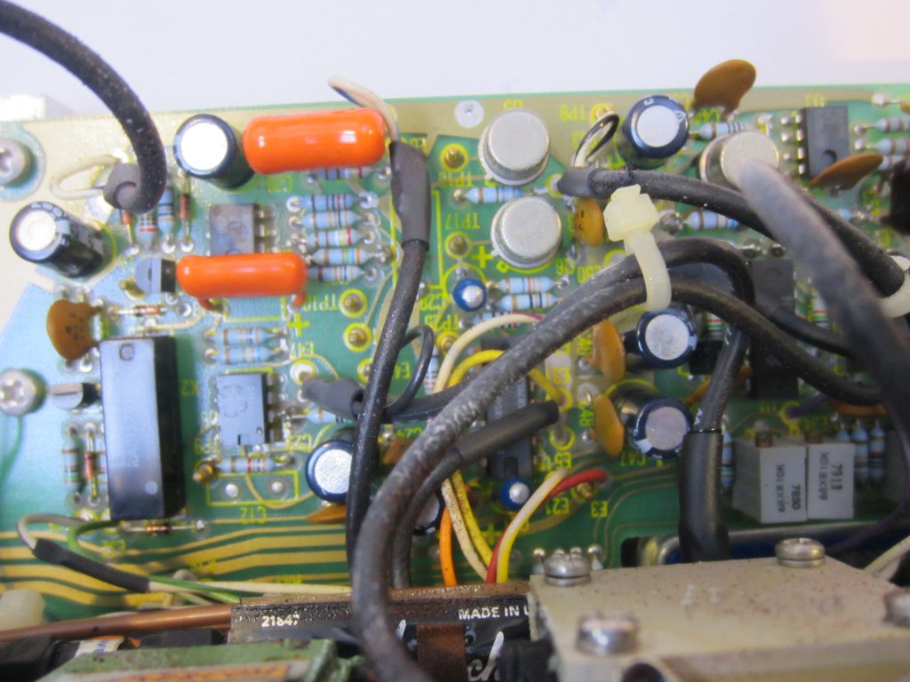

These two pictures below are the top and bottom view of the main PCB (click to see the high resolution version). The date codes on the components also indicate that it was built sometime in 1980. There are some unpopulated foot prints on the board and presumably they are left for options (or could be for the 907A version).
The layout is pretty straight-forward. The big heat-sinked metal can towards the bottom is the RF generator assembly (YIG tuned oscillator). The power supply section is located off the main board on the black heat sink at the rear of the enclosure. From the picture to the right, you can see the push button rod runs from the front panel all the way to the back for the mains switch. This was a very typical construction technique back then so that the high voltage mains wiring could stay in the back and did not have to run all the way across the case.
There are two PCBs stack-mounted on the front panel. The larger one mounted next to the front panel is obviously for driving the LCD displays and some other miscellaneous functions. The other one hosts the microprocessor as can be seen in the picture below. The MPU used here is an MC6801.

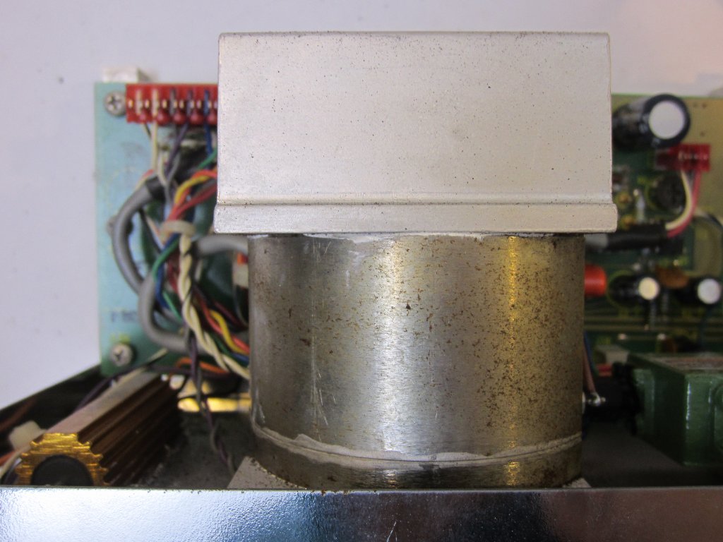

Here are two pictures of the YIG oscillator can. The large 15 Ohm power resistor is the current limiting resistor to the PTC heater of the YIG oscillator. Sadly, the PTC seemed to have failed as the PTC element measures around 240 Ohm under room temperature which is significantly higher than what it should be. This explains why this RF assembly no longer warms up after my initial test.
Without the heater, the frequency measurement display no longer works as the voltage it references to is way out of range. When I initially powered it on though everything did work but I didn’t take any pictures back then. Anyway, as you can see from the picture below the oscillator still works. It just cannot be adjusted to the wide frequency range that is specified.
