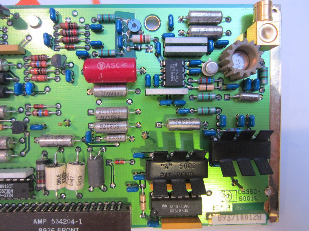

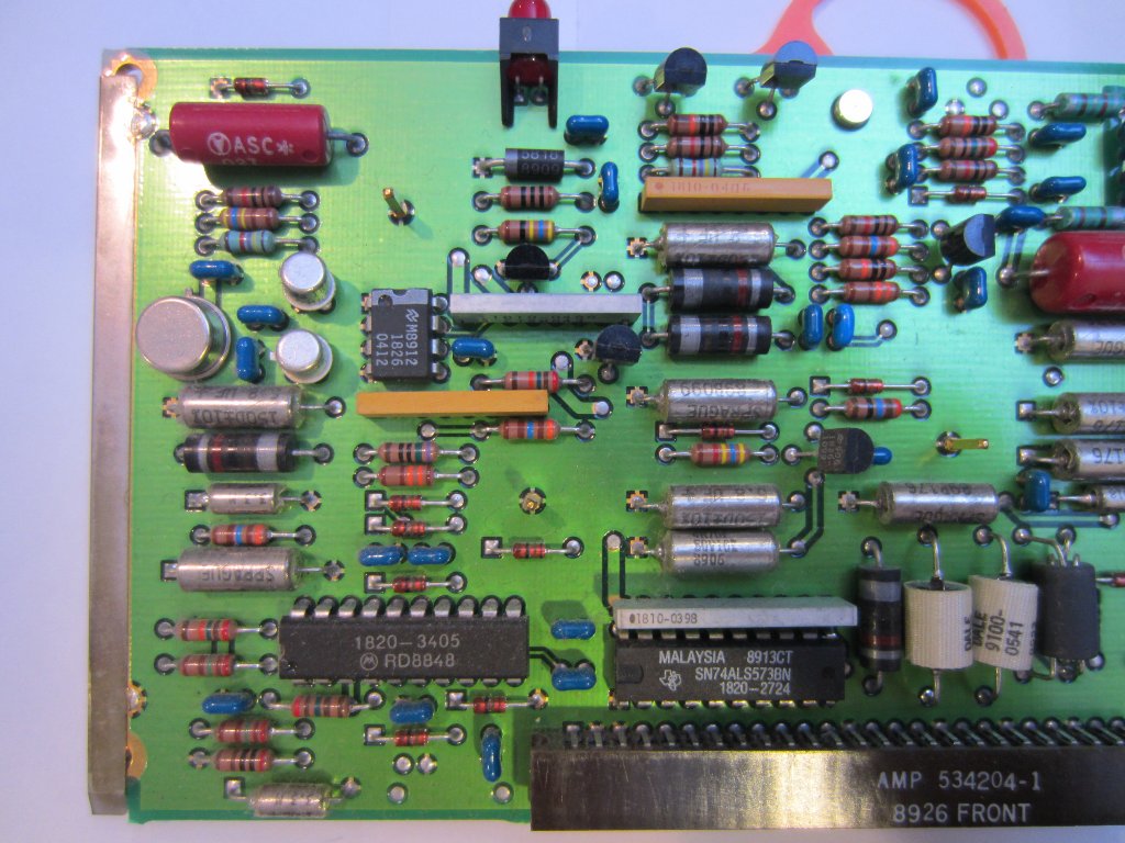

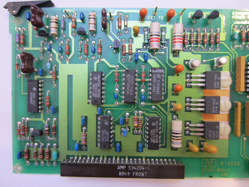

Here are some pictures for the A1 (timebase buffer/power supply control), A2 (low frequency input), A3 (counter) and A4 (microprocessor) boards. The fuse holder on A1 is reserved for an optional 5000 hours elapsed time indicator.
![]() A1 |
![]() A1 |
![]() A1 |
![]() A1 |
