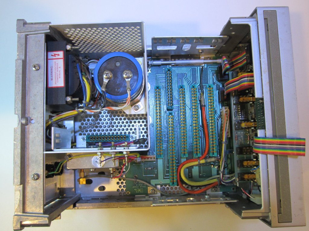

Now let us take a look at what lies inside this ancient power meter. Upon loosening the top instrument cover, you can see a number of vertical boards plugged into the host board mounted at the bottom of the case:
This kind of board-to-board connection design was very popular back then as chip integration level was relatively low and most functionalities were accomplished by the use of daughter boards so that they could be individually serviced and easily swapped out. Here is a picture taken after all the plug-in boards were removed:
The metal can towards the bottom left houses the 50 MHz RF oscillator for the 1 mW reference signal.
Surprisingly, the 50MHz reference signal is not generated by a crystal oscillator, but by a single transistor instead. The output level is precisely controlled via an ALC (Automatic Level Control) circuit. I guess for a RF power meter, the absolute frequency of the reference signal and its stability is not as important as the accuracy of its output power.

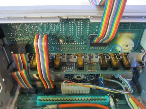

The front panel area as seen in the picture below is mainly occupied by the 7-segment display logic and switch assemblies.
