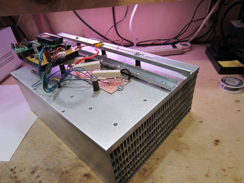

Here are some pictures showing the construction of this electronic load. The heatsink I used is a huge piece of aluminum block I got at a local auction. The original owner builds audio equipment and he used these heatsinks for his class A amplifiers. Anyway, the size of the heatsink is probably an overkill, but it certainly works nicely even without forced air cooling.
The entire control circuit is built on a protoboard. I used the Arduino board I made earlier and used headers to mate it onto the main board.

Here is a picture showing the finished controller board:
As I mentioned earlier, the heat sink I used is ridiculously huge, here is a picture putting everything into perspective:
This picture shows the electronic load operating in constant power mode, absorbing more than 200W of power at more than 60 Volts.
