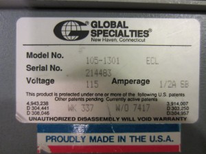

These units have been around for many decades and are clearly showing their ages. One of the things you do not see very often these days is the “proudly made in the USA” sticker on the back.
GS1301A_6
