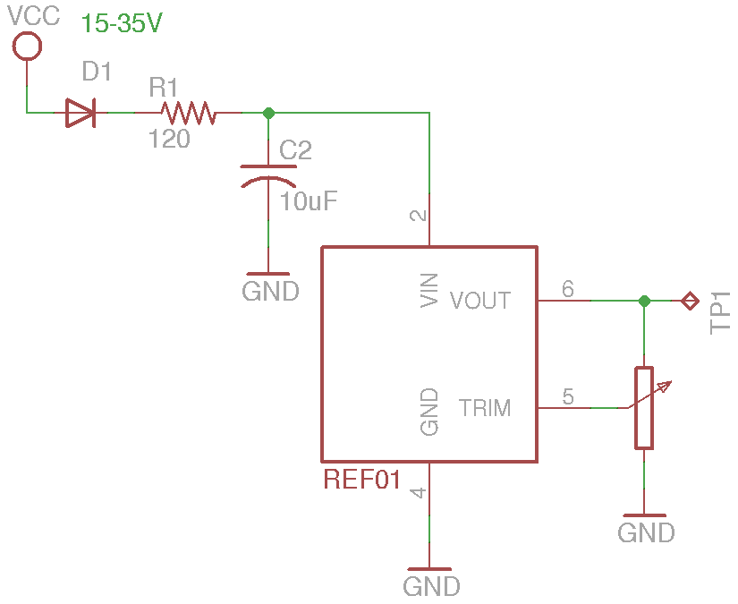

Typically, you would need at least a calibrated 4 ½ meter to calibrate a 3 ½ meter. But if you do not have an accurate higher precision multimeter you can still calibrate your 3 ½ meter with a good precision voltage reference. Maxim’s REF01 (a 10V voltage reference) for example can be used for this purpose. REF01 has three different grades. The E grade is the most accurate, which has a maximum tempco of 8.5 ppm/℃ and an initial error of ±30 mV. The next grade is the H grade, which has a maximum tempco of 25 ppm/℃ and an initial error of ±50 mV. C grade is the least accurate, it has a maximum tempco of 65 ppm/℃ and an initial error of ±100 mV. But even using the lowest grade as a reference, you can still calibrate your meter to be within 1% of accuracy. REF01’s are also quite inexpensive, you can get the E grade for less than $10.
The following schematic shows the voltage reference circuit. The diode (1N4148) is placed along the power supply to avoid damaging the voltage reference should the power polarity be reversed. The L/C low pass filter reduces the noise introduced from the power supply. The 10-turn 10K trim pot is optional. You should only use it if you have an accurate 4 ½ or better resolution meter. In this case, the output voltage can be fine tuned via the trim pot.
