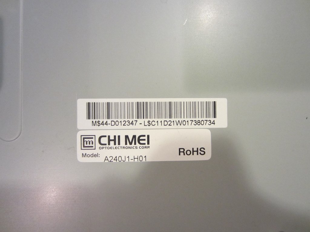

The whole interior is shielded as expected. Take a look at the sticker on the shielding in the picture below, it appears that Westinghouse L2410NM is just a rebadged CHI MEI LCD panel (or at least a significant portion of the LCD assembly was manufactured by CHI MEI).
