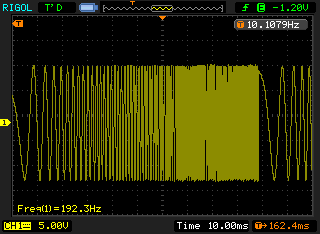

The following two oscilloscope captures show the linear and log sweep generator output along with the synchronization pulse respectively:
And here is a capture showing the function generator output controlled by the sweep signal input. The synchronization pulse is connected to the external trigger input of the oscilloscope for synchronization.
