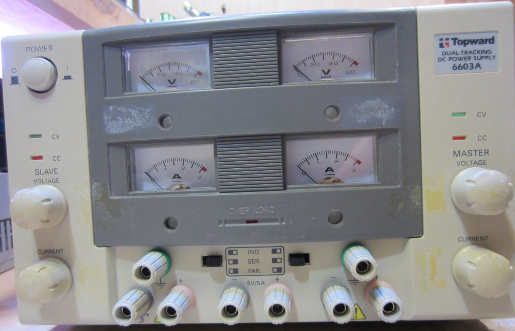

The power supply I got, Topward 6603A, is a dual 60V 3A tracking linear power supply with analog displays. It was made in the late 90’s. There is also a “D” version which comes with 7-segment displays. Judging by the retail price, which is typically in the $700 to $800 range, this power supply clearly is geared towards the professionals rather than the hobbyists. But there are many used ones out there and you can grab one off eBay for only a fraction of that price. Here is a picture of the power supply I received:
Besides the tape residue on the front panel, there is very little sign of wear and tear elsewhere. This unit appeared to only have been lightly used. Before opening it up, let’s take a look at its specifications (source):
