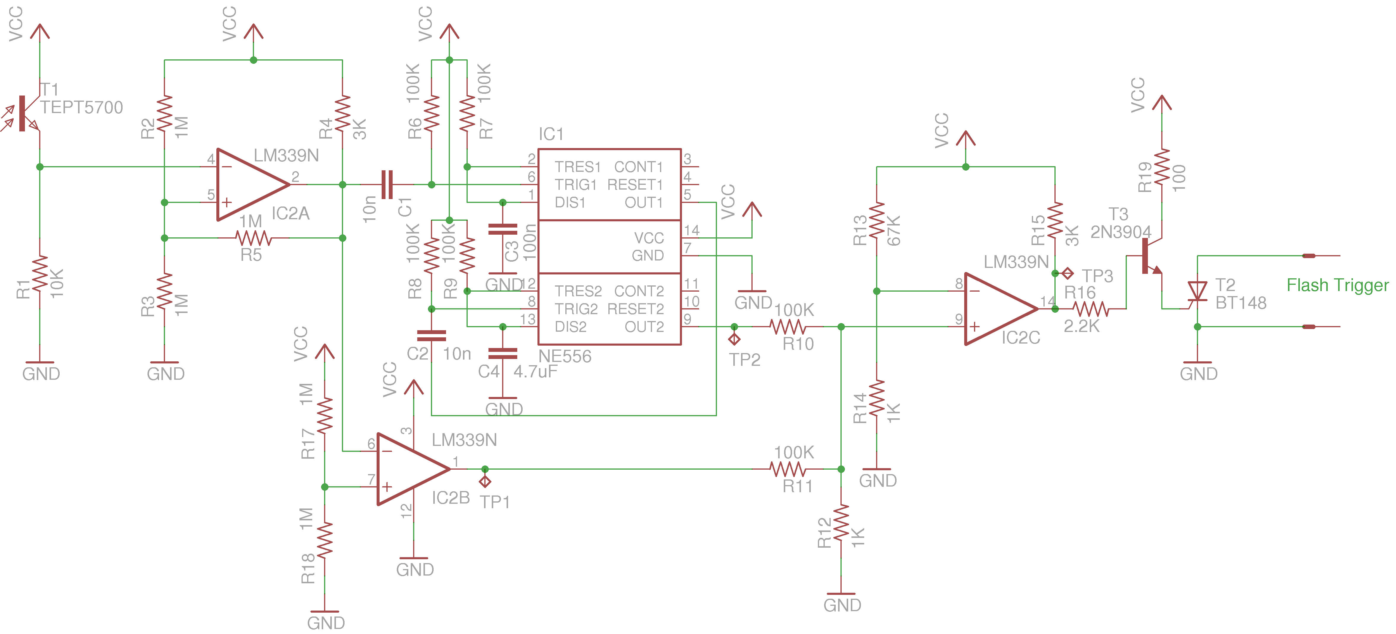

The following is the circuit diagram of the camera flash controller I designed. It operates by delaying the triggering signal and synchronizing with the main flash event.
Here is how it works. IC2A forms a comparator circuit with hysteresis, it normally outputs HIGH. When the camera flash is fired, the voltage at the negative input to the comparator will rise above that of the positive input and the comparator will output a low pulse. This output pulse then goes to a 556 timer (two 555’s) which is configured as two chained monostable single-shot circuits. The first stage generates a pulse with a width of 1.1*R7*C3 (roughly 10ms using the values supplied), and at the falling edge of this pulse the second stage is triggered. The second stage has a delay of 1.1*R9*C4 (roughly 500ms). As mentioned earlier, the delay of the first stage needs to be shorter than the time delay before the main flash fires, and the delay of the second stage needs to last longer than the falling edge of the main flash as illustrated in the timing diagram above.
Besides triggering the monostable circuit, the output of IC2A is also passed through an inverted comparator IC2B to output a positive pulse. No hysteresis is necessary for this comparator as the input is from IC2A’s output which is guaranteed to be rail-to-rail (or the maximum and minimum output voltages of the comparator). Finally the output from IC2B, now a positive pulse, along with the output from the second stage of the timer go into IC2C. IC2C is configured as an AND gate. When both of the inputs are high, the input voltage at the positive input of the comparator will become higher than that at the negative input and IC2C will output a high. Because IC2C is an AND gate, the width of the output pulse is the shorter one among the two inputs and in this case the pulse width would be comparable to the pulse generated by the main flash.
LM339’s current output capability is quite limited and thus a transistor is added to provide the required gate current to trigger the SCR (thyristor). Alternatively, IC2C’s output can be used to drive an IGBT directly as I described earlier.
