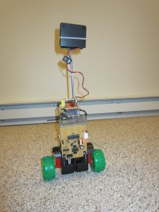

Here are a couple of pictures of the robot in its balanced positions:
And the following is a short video of the balancing robot in action. The stability of the robot can be dramatically improved if you use a properly designed gearbox that has negligible gear backlash. The backlash in a typical toy gearbox is usually quite significant. In my case, the wheels can be turned by a few degrees in either direction before the gears are engaged, and this makes it harder to control the robot accurately. Also as mentioned earlier, larger wheels can also improve stability as the robot will be less affected by the surface condition.
View on YouTube in a new window |
