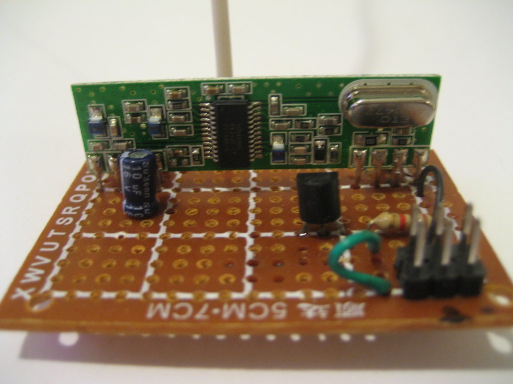

After eliminating any possible wiring issues, I started to question whether the 315Mhz receiver was defective. So, I unconnected the output pin on the receiver from the Arduino RX pin (pin 0 on ATmega328) and hooked it directly to an oscilloscope. When I turned on the transmitter, I could clearly see on the oscilloscope that the waveform matched the encoding waveform of the message sent. So it seemed that the 315Mhz transmitter/receiver modules did work. But as soon as I connected the receiver output to the Arduino RX pin, the waveform became flat and stayed consistently at around 5V.
So it became clear that the output of the 315Mhz receiver module was unable to drive the RX pin. In Arduino, the RX pin is internally pulled high and it seemed to me that the output circuitry in the 315Mhz receiver module does not have sufficiently low output impedance to drive the internally pulled-up input pin and was only designed for direct connections with floating gates.
To solve this issue, I added a source follower using 2N7000 to the receiver output (see image below).
Since the source to drain resistance on the MOSFET is basically infinite, the receiver output is essentially left afloat.
With this change, the 315Mhz modules sprang back to life. The following pictures are the receiver module with this additional source follower output buffer added.
