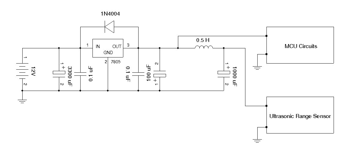

To solve this problem, it is necessary to use a proper LC filter for the ultrasonic range sensor. A typical arrangement is shown here:
In the example above the battery (12V) powers the motors directly. The ultrasonic sensor and other circuits (i.e. additional MCUs) are powered via a +5V regulator. The decoupling LC circuit is placed between the +5V power supply and the ultrasonic range sensor. Using this arrangement the interference from the power supply ripples due to non-resistive load can be virtually eliminated.
