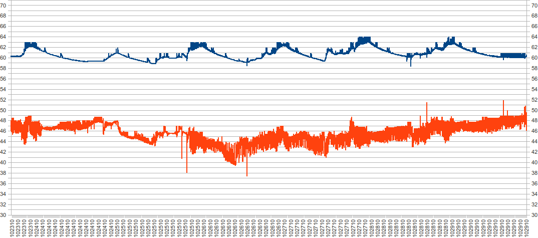

Even at this relatively high sampling rate, two weeks worth of data consumes only around 5 MB. And here is a raw data plot of the temperature and humidity in the room for the week week between 10/23 and 10/29 (blue line is temperature and red line is humidity):
Since the raw data set is pretty large, I could only get half of the data plotted using OpenOffice Calc without further processing.
As you can see, the data came out pretty nicely. After this proof of concept run, I am going to let it run for a longer period of time and gather more data…
