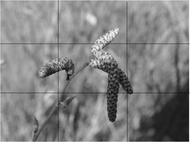

Image Regions
For images with complex contents, it becomes difficult for the Hough transform to reliably identify line structures within the image. Future more, certain photography techniques (i.e. Bokeh) leave portions of images deliberately blurred. Without dividing image into different sub-regions, the classification results would be compromised.
Thus, images are divided into 9 (3×3) sub-images after Canny edge detection, and Hough transform is performed against each sub-images. The figure below illustrates how an image is divided:
This technique is especially useful when portions of images are deliberately blurred, like the image shown above. It also helps the line detection accuracy when the image contains complex scenes. By dividing up the image, each sub area’s complexity is greatly reduced. Other methods in scene separation might achieve even better results, but it is out of the scope for our discussion here.
