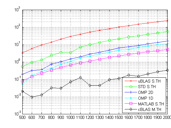

The following table shows the results I obtained by running the code listed above. The results are time in seconds. (note, S.TH means single threaded and M.TH means multi-threaded).
Size/Algorithm uBLAS S.TH STD S.TH OMP 2D OMP 1D MATLAB S.TH cBLAS M.TH

The following figure shows the results. Since uBLAS and single threaded matrix multiplications took significantly longer to compute, I did not include them in the figure below.
Matrix Multiplication (Linear)
The following figure shows the same data but uses log-scale Y axis instead so that all the data can show up nicely. You can get a sense of various algorithms’ efficiencies here:
Matrix Multiplication (Log)
