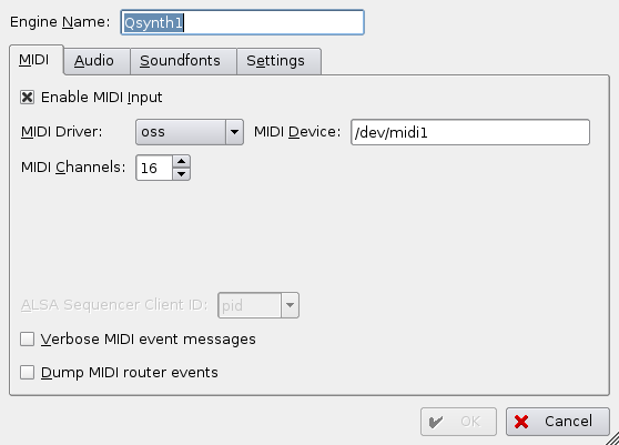

To use OSS, all you need to do is to choose the correct option in qsynth:
qsynth settings 1
qsynth settings 2
If you have multiple sound cards configured like in my case, you can select from which sound card you want the sound to be outputted (e.g. /dev/audio or /dev/audio1 etc.). The sound does not have to be produced on the same card where the MIDI device is connected. In fact, using a single sound card as the output device might be the most attractive solution since otherwise you will need to have one pair of speakers connects to each of the soundcard output. In my case, the Sound Blaster Live! card is only used for it’s game port to connect with my MIDI keyboard.
After you have successfully restarted qsynth, you should be able to hear sound when you press on the MIDI keyboard and you should see the indicator on qsynth flashing, indicating that MIDI signal was received.
