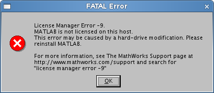

And if the serial number is set incorrectly, the following message will be received instead:
